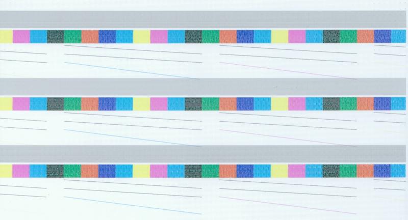

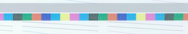

I have a Falcon Outdoor Jr. that has been running smooth for a few years that suddenly started having a bad nozzle check pattern between job runs one day. I attached a picture of the nozzle check. Looks like random white lines running thorugh it. I ran some heavy cleanings on it and soaked my printheads with no improvment. I called out a Mutoh tech that tried to tell me it was my heaters. I checked my heater temps and they work how they should with an even temperature across the plate. He went ahead and replaced both the print heads but that still didn't help, he left telling me good luck with that. It does this regardless of the media and I have even swtiched out my ink just in case. The humidity is controlled in the room and the machine stays as clean as possible. I have just ran out of ideas and was looking for any suggestions. If I print at high quality customers don't complain or haven't yet, but it isn't cost effective to keep that up.

Ditto! In the images you posted they don't look bad at all considering the low resolution a nozzle check prints. Print a (test print) small blocks of C,M,Y,K,R,G,B and maybe a bitmap and a gradiant and let us see. Soaking the heads can really work wonders.
