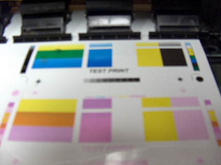

alright checked the seal to the best of my knowledge but didn't seem to help... put in the old damper. pulled ink and cleaned got this first print in the pic with a streaky magenta.... pulled again it got worse pulled again... and then no magenta. after these prints i pulled ink and lost the cyan. its like it gets worse after i pull ink some of the time?

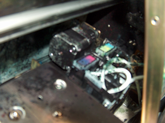

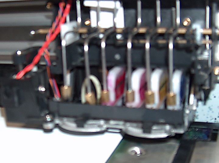

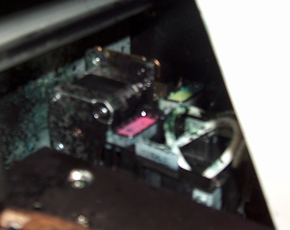

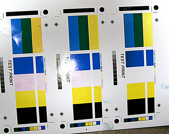

update i took a piece of tube and closed off the blk and cyan nipples .. and then pulled ink after the pump. pulled magenta a lot of it.... did a test print and the space for magenta still blank but print magenta instead of blk. did a cleaning and got all colors back but magenta? looked at top of capping station and it looks like its pulling all the colors including magenta. its just won't print magenta. the first pic is with the dampers off of the blk and cyan and the tube attached to the nipples on the head. the second is the capping station after pulling with the cyan and blk blocked... the 3rd is the first test after the magenta was pulled and the test print after one cleaning. the last is the capping station after a few cleanings ... it looks like its pulling all colors

Graphics2u
Is it possible that the head is bad? I don't know if just one color can go out on a head like that. Maybe someone else knows.
Bradster941
MacDaddy, doesn't the damper in his picture look too full?

on an nozzle check after cleaning i have all back except for a few magenta nozzles.... but every nozzle check its different ones that are missing from the magenta? like some are good one minute bad the next....

Post up a pic of the nozzel checks that keep changing.
