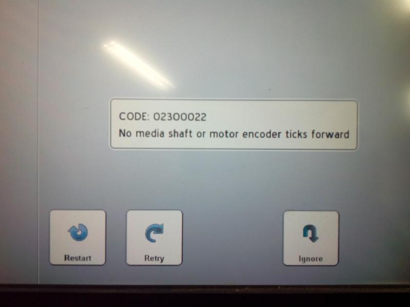

The printer was working fine and then... This error appears and the media belt stoped working! I allready replaced the high definition encoder but it doesn't solv the problem. The media belt motor was tested out of the printer and it works fine.
I performed a measurement of continuity in the wires and everything was all fine...
Has anyone had a problem like this?
I suspect the I/O board or motor controller board...

thats the result for 02300022:
02300022 Media Feed Encoder Error No media belt or motor encoder ticks forward
Current being applied to motor, but neither encoder isrecording motion.
Check motor wiring. Check motor functioning. Check motor encoder and belt encoder.

I removed the media motor and encoder and installed on another FB950 and gave the same error. I swapped the encoder plug and plugin at the original encoder and the error desapears! figured out it was the media motor encoder. I buy a new encoder, installed and... it keep the same error...
The wires are all good and the conections too!
Today I'll replace the motor control board and see if something happens... I can have volts at Plug J8 Pin 5 and 6 (-) and pin 4 and 5 (+) referent to the motor control board at E-Box!
Thaks for the help everyone. If someone have more ideias...
