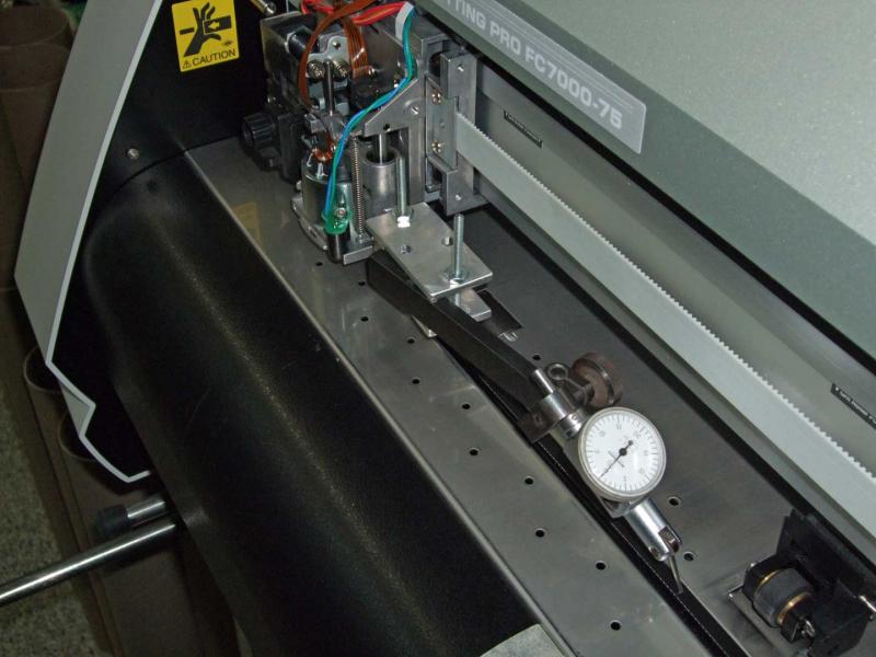

Thanks for your input, omg. I don't think there are any loose connections, but I will take the cover off and look at the big ribbon cable. It could have been bumped or the carriage could have struck something. I attached a micrometer the best I could and it looks to me like the carriage stays parallel to the platen.
