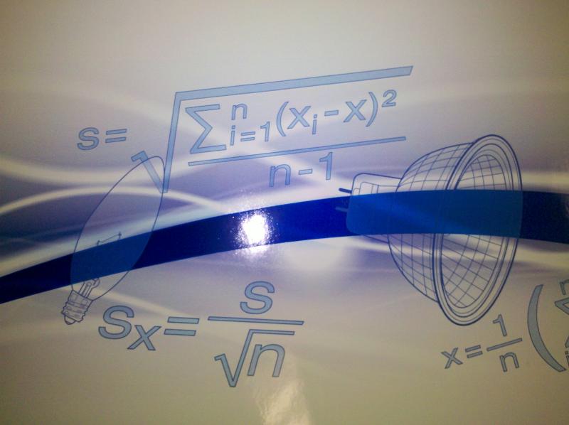

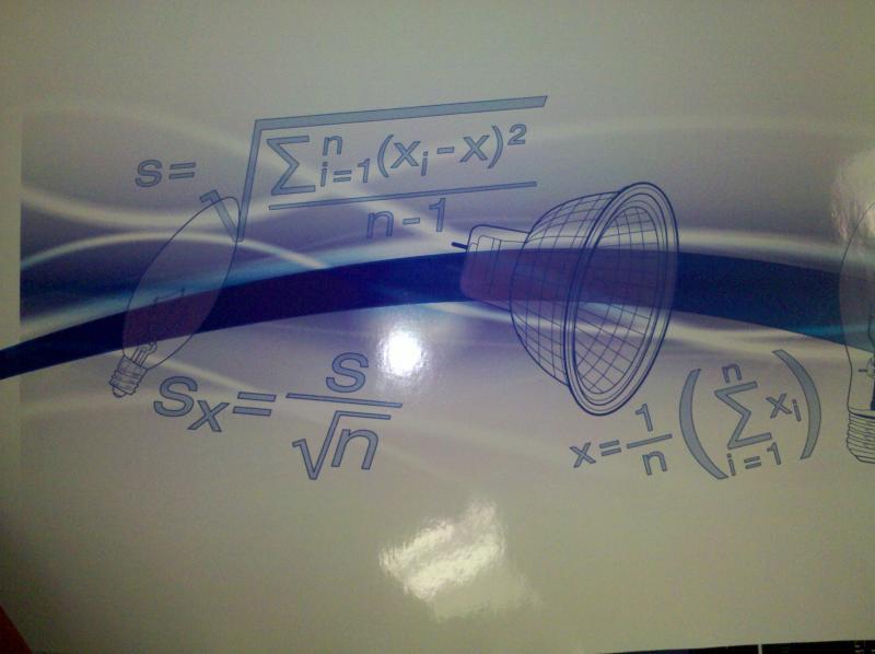

I have been testing 10.5 since Thursday and I don't really see any differences on the Flexi Design side of things. On the RIP side they have replaced CPSI.exe with ARIP.exe. I have tested several PDF files, and there have been color improvements in shadows and dark black areas as well as in a transparency within one of the pdf files. In the attached pictures both prints were printed on the same media with the same profile on the same printer so the only difference was the new RIP Engine. You can see that in the print from 10.5 the color in the light bulbs stays blue where it shifts to Purple in the 10.0.4 print. Rip times seem to be the same so far just from watching it but I haven't sat there and actually timed it.
