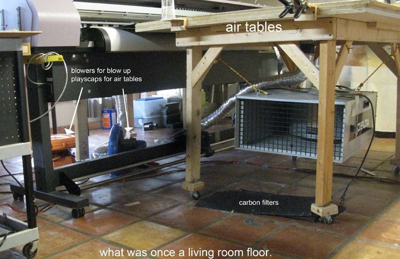

i wouldn't get too "fancy" with what kind of activated charcoal is used. the basic stuff works. i remember a long time ago at woodcraft they sold a filter that fit in the unit. it was $50 and worked for about 2-3 weeks. still wasn't a better solution than getting filters from lowe's and cutting them up. in the end you are wanting to buy as much carbon for as cheap as possible.
and yes keep the unit low, mine is suspended between the legs of a work table. just sitting it on the ground doesn't work as well because the air comes out too low and tends to blow aggressively across the ground. just raising it a foot off the ground allows for it not to stir up so much dust on the floor.
there are some other interesting links that i looked up that have inspired me to maybe change my design a bit. i might use granules in a shallow screen box instead if i can find them cheap enough.

here's the way i have my scrubber set up.
