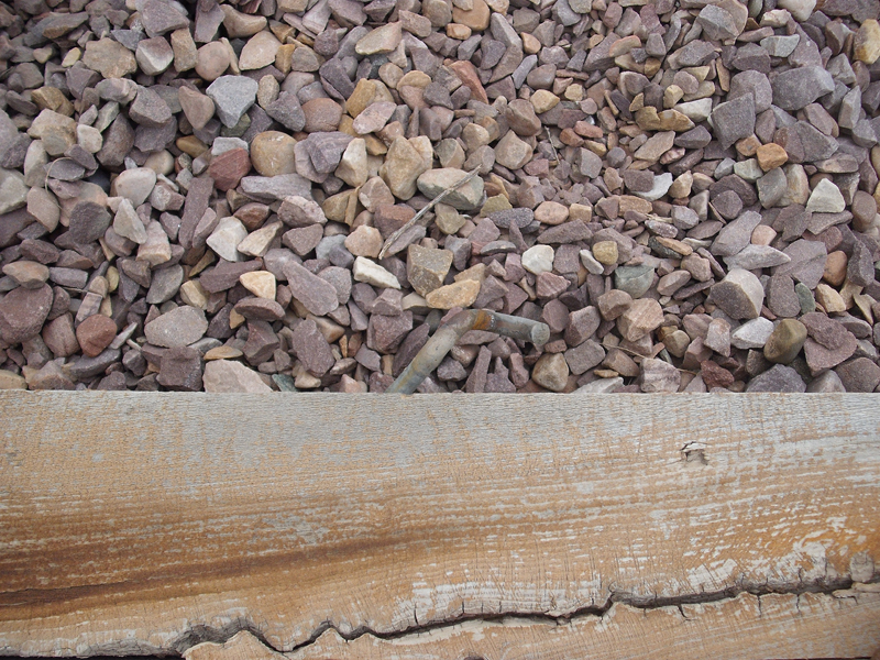

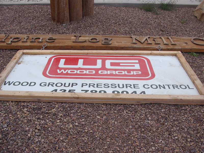

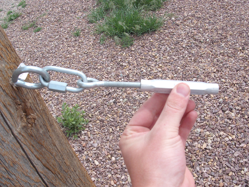

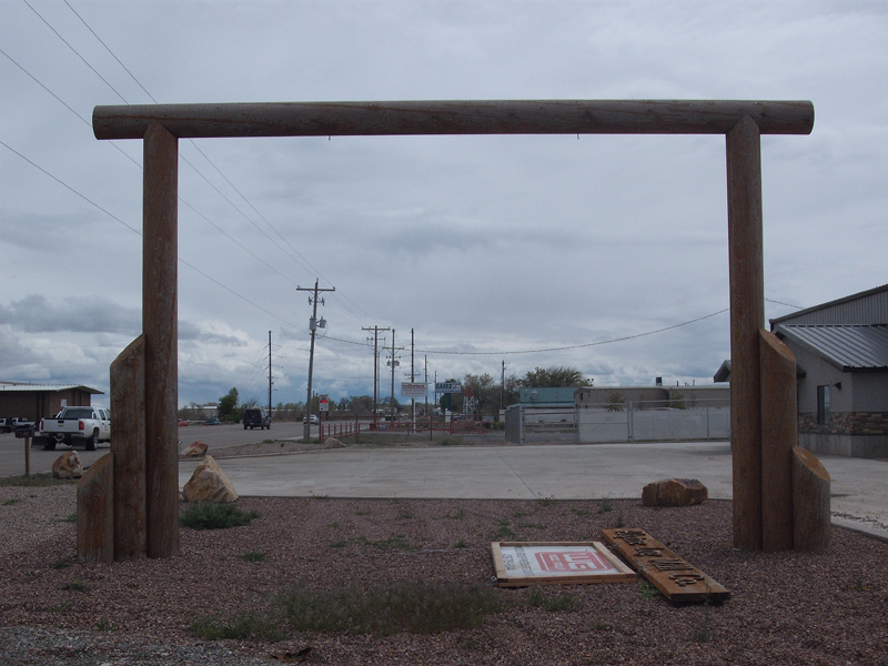

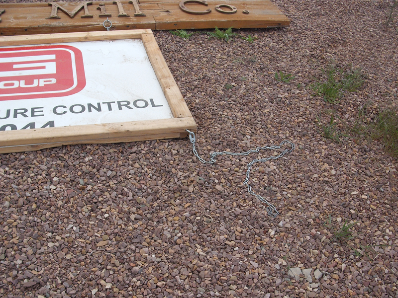

Recently we had a client come in asking if we could re-hang a sign for him. We said sure thinking it would be a pretty easy task but when we got out we realized it might not be so easy. It's a huge log arch that he wants to hang the sign from. He previously had it bolted in with some huge hooks and some pretty hefty I-Bolts. He said the wind had blown it down several times before and that's why he had come to us. Everything that I would have thought to do he had already done. So.... any ideas?
More pictures to come.

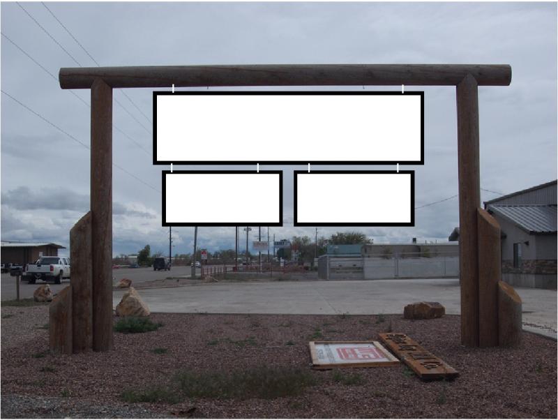

As you can see in the above pictures the hook he had in there previously was just completely gnarled so that's evidence to the fierce winds we have have to deal with here. The Big wooden "Alpine Log Mill" Sign is going to be removed and we're going to be adding 2 small Attached signs to the bottom of the big "Wood Group" Sign. I'm thinking that by removing that 100+ lb weight we might have a little more success in keeping it hung.
in my experience most of this type of sign mounting fails because of the swinging motion when the wind picks up which eventually wears at the sign or the hardware itself until it fails. i always try to mount signs with a rigid bracket rather than chains so that there is NO swing. i have built more brackets than i care to remember to fix this issue with hanging signs. i have never had to go back after replacing the old chain / swinging sign issue with an appropriate rigid mounting system.
i have encoutered a couple of clients over the length of my career that insist on 'chain' for visual reasons and in those instances we have welded the chain so that there is no play in it, but i always tell them that i am going that direction because of their requirements and that it is not my recommendation and there is no warranty/guarantee, i would much rather have the sign hanging on a rigid post.
You can't have that many panels hanging from chains all over the place. If you want that many free roving signs.... I'm afraid you're going to have to use some heavy metal strap and make a solid brace running up and down the outside of the sign and keep them from blowing around independently of each other. I believe your/his problem is all the inter-smashing of signs at different times and rates.
Usually little ryder panels can hang from chain, but not so pretty good for larger signs.
Also, don't sandwich your alumalite or PVC between two pieces of wood like that. That is the dumbest way to hang a sign.
Billct2
Swinging signs should swing, check chains are what cause the problem, creating twisting that works bolts loose.
Either install it as a swinging sign (with suffiecient hardware) or install it as a fixed sign.
I would set up the new sign as one large panel, not add-ons that only adds to the problem

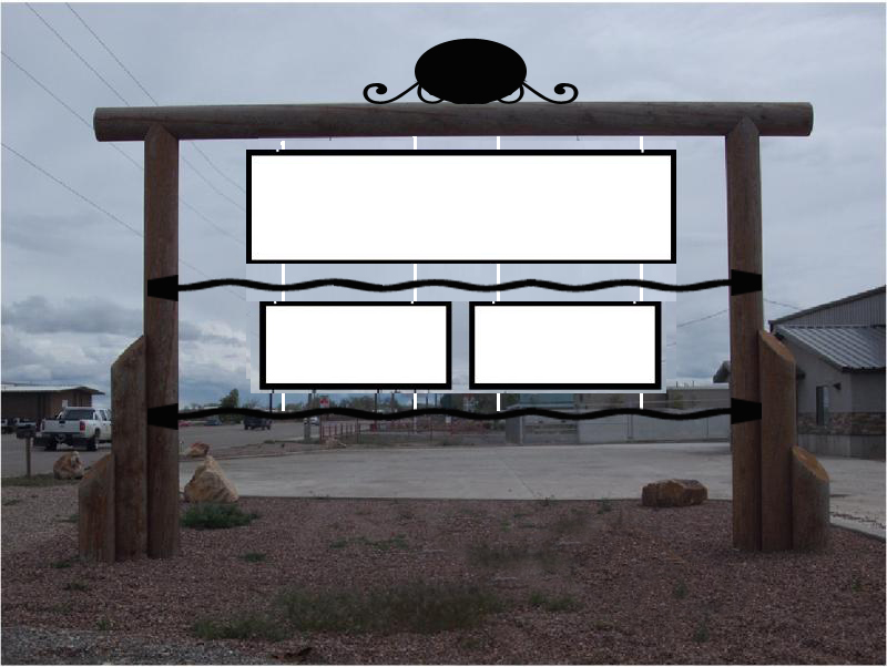

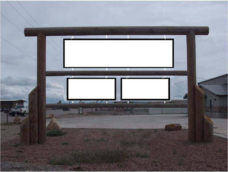

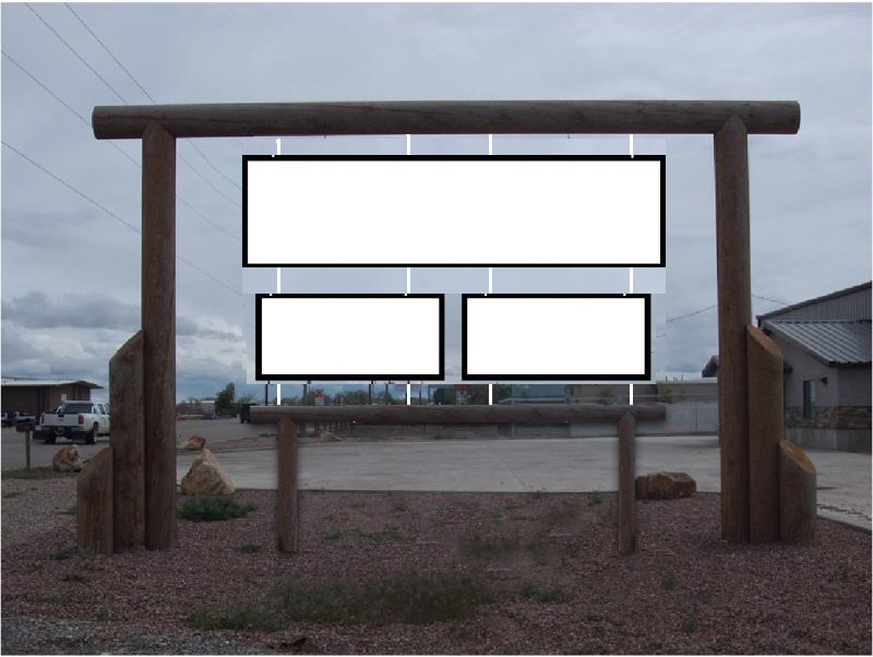

Is there any chance of getting them to improve the structure, rather than trying to solve the problem with hardware? Maybe with cross beams, or a hitching post style, secondary structure?
GypsyGraphics
If the aged wood vs new is problem, how about iron. It might be easier to attach and maybe tie it in with an iron element at the top. (more rustic, less woopdie-do than this PSD quickie)
cha ching... up-sell
GG...
I'm afraid that if your sign panels are still attached with chains top, bottom and middle... you'd eventually knock those aesthetic iron free forms for a loop-tie-loo. You'll be back with the OP's original problem.
Possibly in Southern California, you might not have the same wind loads that the OP would have in Utah.
Regardless, it's not a good idea to attach so many objects with chain anywhere. Its kinda the reason big pylon sign are one solid piece for all those store names in the mall. They're all substantially connected and rely on the next one's strength to keep it all in check.
GypsyGraphics
I was assuming the chain option was already off the table. I didn't address what might take the place of the chains, but was thinking straps or rods (iron rod if iron beam)... which would in turn be attached to the cross beams.... a completely ridge structure all together.
"Regardless, it's not a good idea to attach so many objects with chain anywhere."
but... even if they wouldn't give up on the chain idea, having the cross beams at least means not attaching any two objects together.
Still I agree, no chains at all would be a much better solution.
