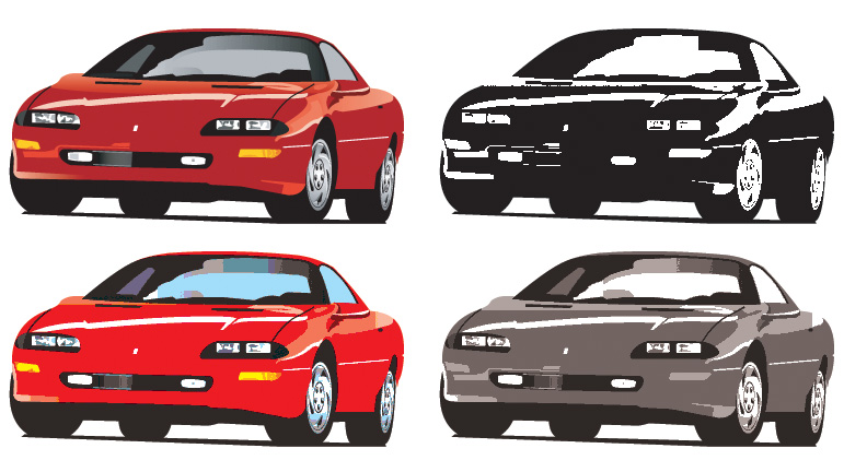

    The Pro Design is expecting a vector EPS file with a header and content to match. The raster EPS generated by Photoshop is not the same animal at all and will not be recognized.
    There is no reason why you should not be able to import and use a JPG file as either an image to be autotraced or as a template for drawing on with the Bezier pen. What you must realize is that autotracing has real limitations if you are working with a JPG or any other bitmapped file in full color. If you wish to autotrace that, you will need to become familiar and experiment with the effect know as "posterization".
    With posterization, the number of colors in the file is adjustable and they are reduced from the original number of colors. Reducing the number of colors becomes a balancing act in preserving as much integrity of the image as possible while still ending up with a relatively small number of colors to autotrace.
    The image below starting in the top left and traveling counter-clockwise shows the results using Photoshop CS2:
    • The original image
    • Full color posterized to 4 levels
    • Grayscale posterized to 4 levels
    • Black and White using the Threshhold Command

    I am not familiar with Pro Design but, if it is a private label version of FlexiSign, then is most likely will perform an autotrace of black and white, grayscale or color images. So, no, I am not saying that you must always be in a black an white color mode.
    What I am saying is that you will, because of the need to posterize, get widely differing results at different levels of posterizing. This is where you, as the creative control, must exercise your judgment. In addition, you will also want to match what the software presents you with in an automated routine such as posterization or autotracing with what you and your client want in the finished graphic as well as how many colors the budget for the production will support. If, for example, you want to take a full color image and produce it in just two colors of vinyl, then you will not want to posterize to a level of six colors. You will have more colors than you have a budget to produce the job.
    Often, in this area, we have seen unrealistic expectations as to what the "state of the art" actually is for modifying unsuitable artwork into usable vinyl-cut-ready artwork. The fact is there are no pat answers. Each image and each job presents a different challenge in how to get from where you are to where you want to be. That is where talent, experience and artistic judgment come into play.
