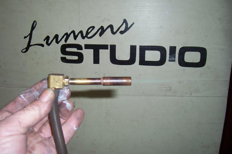

Z SIGNS
I use this.It's a tipping off torch on our neon bench.Shoots a very hot pointy flame.It's about the only thing our neon bench is used for.
