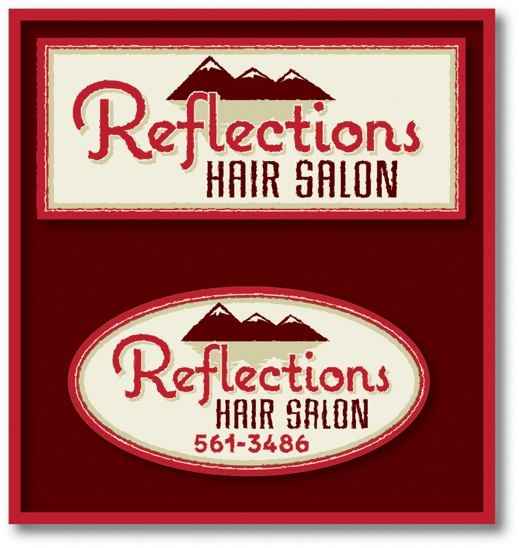

Okay so I whipped out a quickie layout, using the basic principles on "Mastering Layout".... then I jacked the image up with a simulated bad brush job.
Painting is a skill that comes with practice. A decent design can still work, even if the production is executed poorly.

SignManiac
Rick that's a good point you're making there. I learned a long time ago, a strong design will carry poor lettering but, great lettering will not carry a poor layout. Or something to that affect.
:thumb: I think you have conveyed along with a visual display what was needed and I hope the OP was looking for. A very nice, simple and straight forward
constructive critique. Nicely done!
