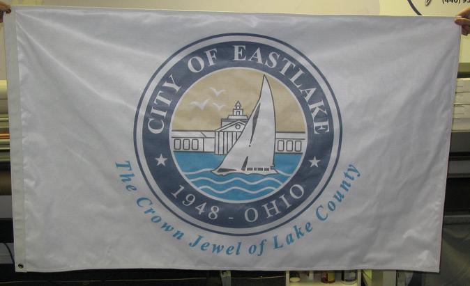

Used polyester true flag outdoor flame resistent for the flag material. Made in Germany by 3p Textiles. Great stuff.

And what about printing double sided?
It is double sides, just print two exactly alike, sandwich with Dupont tyvek and sew. the way we sew ours (this one) was to first serge the edges so the tyvek is even at the edges, then we double stiched a 1/2 edging around the border, finally close up the pole end and sew on a 1 1/2 inch header, then grommet. We then press through our heat roller so it is wrinkle free, fold it up a put in bag.
