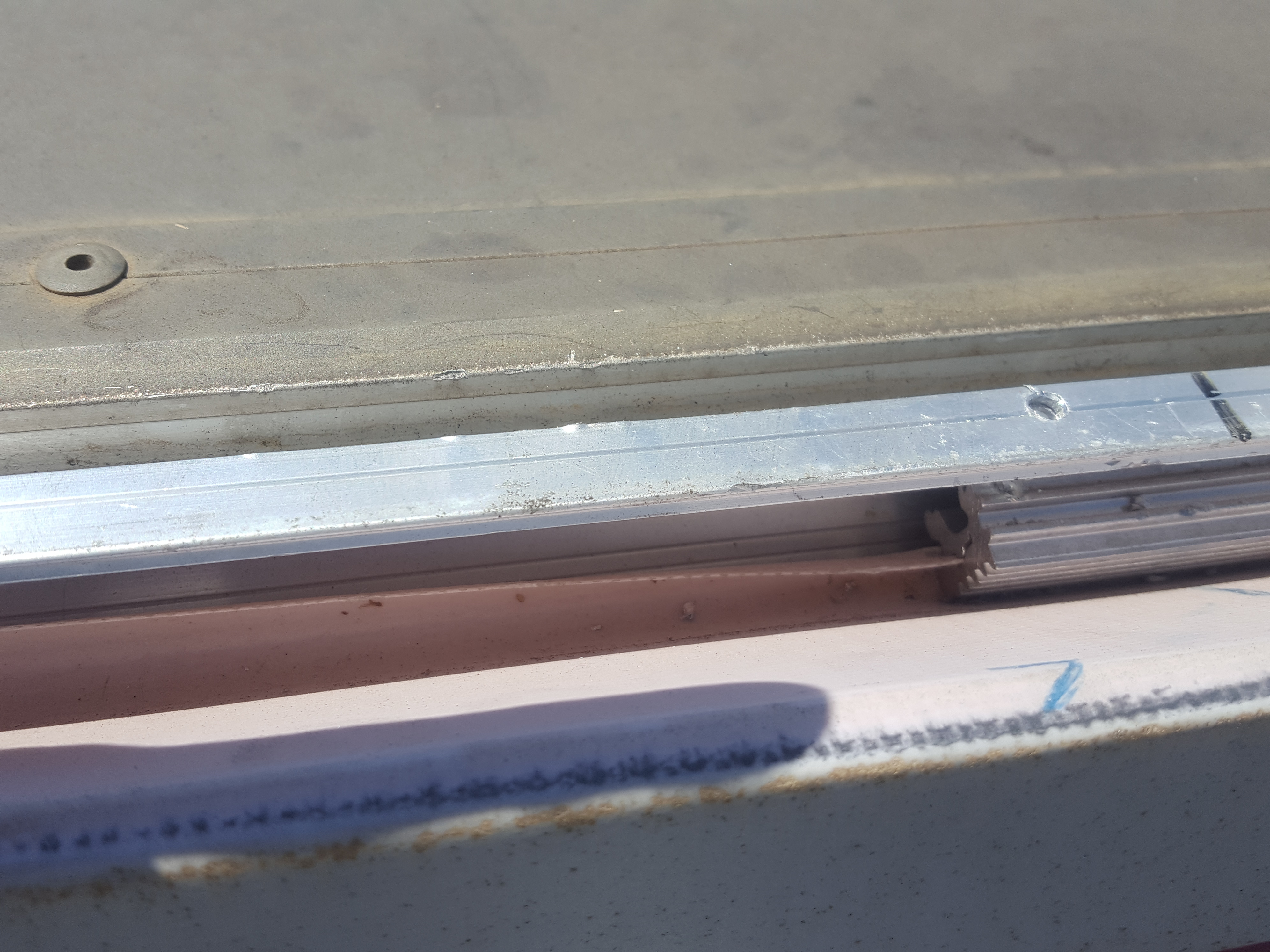

How do you install these clips in a flex face
d fleming
I was going to post you a pic of the tool but it's been so long since I used it I can't put my hands on it. I believe I got it from signcomp as well as replacement clips. Basically it's a funky wrench for spinning the clips in and out to tension.
