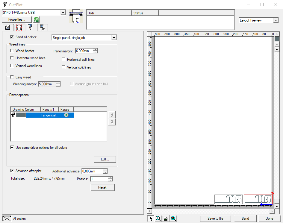

There should be some type of Advance after Plot option. I'm not familiar with PM and Summa menu options. Could you share a screenshot of them?

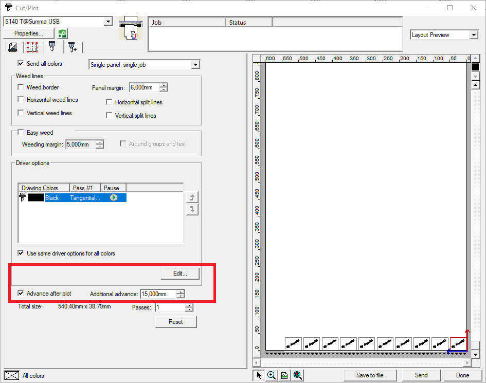

Now this was fun. Your answer was similar to support and I thought that did not make any sense, because I wanted the plotter to make the advance before the plottjob I am sending and not after. But it turns out that the cuttest that the plotter performs is like any other plottjob, and the plotdriver/dialog realize this. So when I enabled the choice for "advance after plot" and put in 15mm advance after plot it did exactly what I wanted. When I now perform a cuttest and click send after adjustment of the pressure, the media advance as it should before starting to plot. I suspect I may have done this rutine/research before then and have just forgotten the recipe. Thanks for your time and effort.
