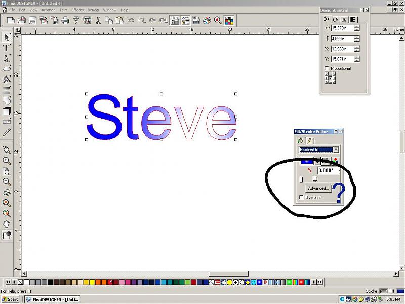

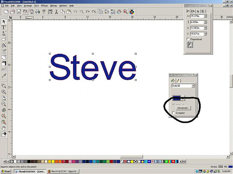

Hey guys,
Has anyone experienced this before?
If you notice, the wireframe button is really cut off, and when I do a gradient fill, its impossible to modify because that as well is cut off and missing.
Someone help!
I called the place where we bought it from and they were no help at all.
Thanks.

SignsRus
ctrl + f = wireframe
CLOSE FLEXI
Goto
Start Menu - Flexi Sign - Preference Manager
Clear the program preferences
*WARNING* This will reset Flexi to default. All your toolbars and menus will be reset
Usually the first step when troubleshooting flexi
gl

PMG
Welcome to the wonderful world of Flexi !!! Flexi got so many problems it not funny!!!!!!
Font may be missing.
Had this problem @ 6 months ago . If i remember correctly this was the fix. - sserife.zip font was missing. Go figure how this would affect anything but after install was back to normal.
