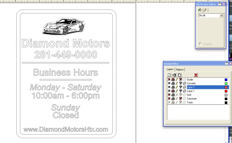

Hello Folks,
I am printing and plotting on a hybrid roland sc500
I need a hand on how to lay out and send this job to production manager for printing and cutting.
I am making a business sign for a customer. I want the basic sign border & Lettering simply plot-cut directly out of white vinyl only - no ink whatsoever on this area. I also wish to insert a black printed car image with a contour cut around the outside.
Here is the basic outline:
basically I am trying to send the job to the production manager to simply print the Car image, and then, after drying.. cut the sign border, letters, and the contour cut around the printed vette image.

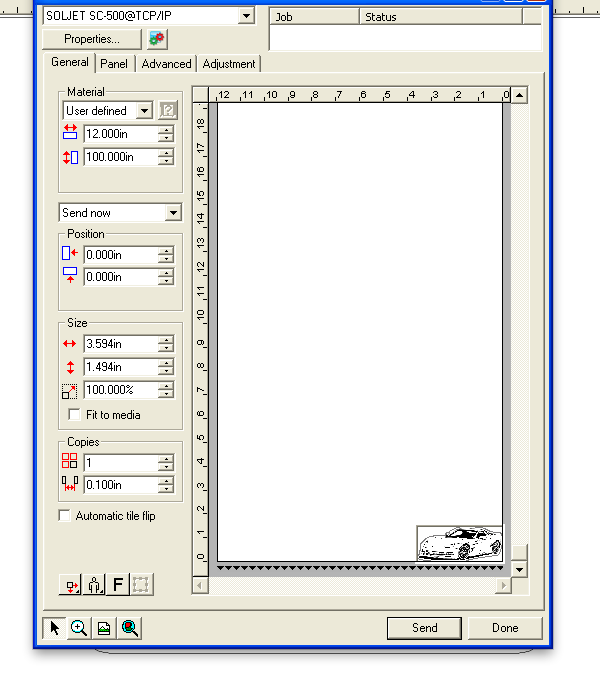

If I set the sign border and letters to not printable in the layers palette & send the job, production manager simply prints the car image in the lower left corner of the media losing it's relative position in the sign overall as in:

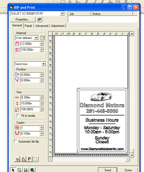

What I wish to accomplish is this at the production manager, but only printing black ink on the car image itself, and no ink on the letters.

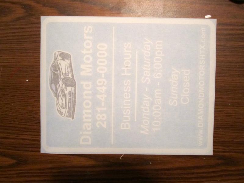

lodcomm
Hello All,
Thanks to everyone for the help - I got it to work perfectly by following Bobs procedure.. I layed out everything on one layer, then simply selected the text & Border(s) and then selected "Arrange-->Convert to outlines", then "Arrange-->Contour--->Make Contour Cut" - then Imported the Corvette as a b/w bitmap, placed it in its spot, selected it and used the "effects-->Countour cut" and created a .010 contour around the car. Sent the whole thing to production manager using rip+print. All worked out well in one single procedure.. The car was printed in black, rested 5 mins for the ink to dry & then plotted the contours.
Here is the door sign with the transfer tape on, ready to send:
Thanks again to everyone for helping a newbie along!
