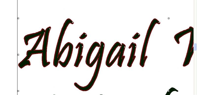

    I have a font that does NOT come in bold.
    So to bold the font in Flexi/LXi I added a slight outline. When I attempt to compound or weld ... it just does not happen no matter what I do.
    Fred suggested I creation the font to outlines and then add the outline and weld the two together with the same color. I tried that and no luck.
    I need the outline welded because I prefer to not have the outline show in the cut vinyl.
    I have attached a picture of what I mean. Anyone familiar with this welding procedure? There has to be a way. I weld objects all the time, just not fonts.
    Thanks .......... ~M

    after you make the outline...go to effects and seperate the outlines, then delete the letters, keeping the outline
  3. SignTech
    SignTech Guest
    WOW ......... you rock! That was so easy ....... I am going to take the rest of afternoon off!
    Thanks! Mike
