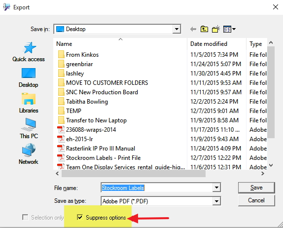

Check this... When you export as PDF, uncheck the box that says suppress PDF options. That will allow you to set the scale on the PDF and make sure it says scale to Full Size. Not sure what else it might be, but if you have illustrator or corel you could check the PDF before you send it to Zoo to make sure its the right size.

I just have flexi sign. I even imported the pdf I sent them and it comes up right to my sizes i set it at.
