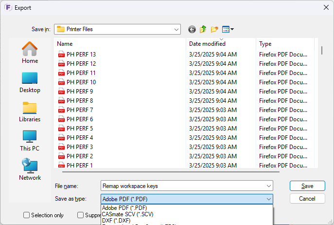

Not on my version 24.2.0 build # 4646

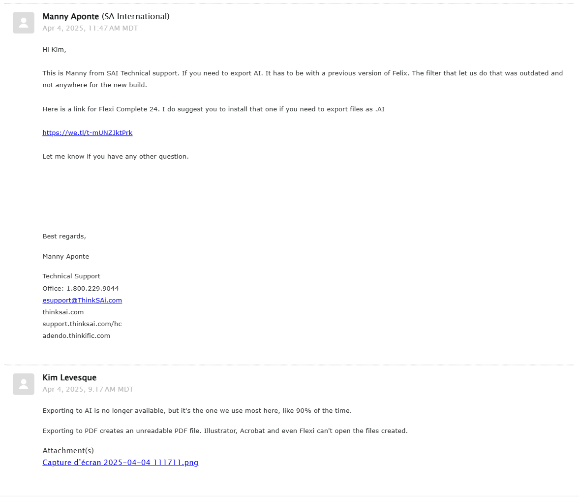

Version 24 has AI and PDF import and export. But not version 25. Here is a opy of what I received from SAI support. It makes no sense, why would you upgrade and lose abilities?
I've also had issues importing PDF, EPS and AI files. I'm keeping both 24 and 25 on this workstation, hoping they somehow change their minds and fix it instead. Otherwise I'll keep using version 24.
For the record, they've decided to fix this because enough people complained about it. According to the reps I talked to they removed the feature because it was "too dated"
