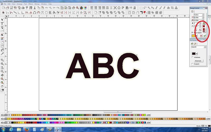

This is what you want for a solid back. Under outline option it let you select with or without a backing.
jmmccann
Okay, I knew I had used this before. I guess the reason I couldn't find it is because the graphic is imported in Adobe Illustrator format. So, there's no way to do this with an imported vector file right? This will only work if it's created within Flexi?
