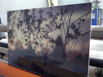

I've only played around with this on a few personal projects but I've had good results. After I've mounted my print on foam core I have installed a 10 mil thermal overlaminate on top of the foam core.
It made the corners incredibly durable and the foam core more resistant to warping (It'll still warp if it's leaning).
I've got a couple of samples that's been around the shop and they still look as good as the day I made them.
I'm curious if anybody else has ever tried something like this? I've thought about offering it a product but I'm hesitant since I haven't heard of anybody else doing this.
I'm attaching an example... I did this a few weeks ago it's still looks good. All I have in stock is a glossy thermal overlaminate it would probably look better as a matte.
