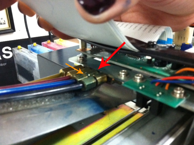

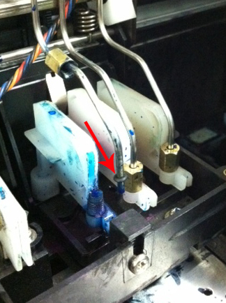

So I have been having problems with my falcon outdoor jr. The blue ink stopped coming out completely. I opened it up and found I need to replace the o- rings so I ordered the 2mm ones. At first they seemed to fit fine but when I started printing there was still air coming through to the damper. So my question is what size o rings do I need fro the ink line and also for the damper. I will post pictures soon!!!
Thanks !!!
Signsfactory1
Here are the pictures hopefully it helps!!
Thanks Again

Umm yes I did buy the o-rings from the same place I saw the dampers but like I said they are too big. They still leave a small gap where the air come in through..
and as for the 3mm o-rings I believe in this machine the ones that connect to the damper are actually smaller..
Yeah these o-rings look as though they would be universal but I still have air going to the ink. If I pull the ink directly from the ink line there are no air bubbles. Then I connect the ink line and pull ink out from the damper line and I get air bubbles so the problem is there but getting an air sealed connection is becoming complicated...
