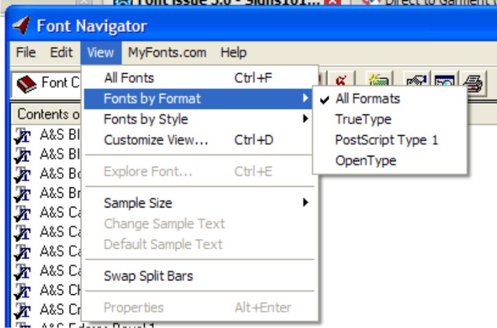

    Signmaniac are you saying you do not see any OpenType in your preview? On my system some do show up and some don't!

    They don't show up in Font Navigator at all. They show up in Corel X5 ok.

    Do you have show all fonts selected?
    See attachment!

    Sure do, wondering if it might be a memory issue. Truetypes all display fine though.

    might not have upgraded bitstream when you upgraded corel - bitstream FN 4.0 has no opentype support, but 5.0 does...

    Thanks, I'll check the version.
    Just checked and it's version 6.00 the latest included with X5
