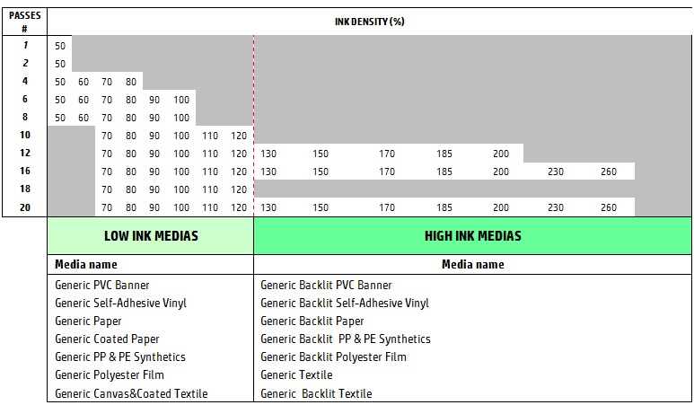

But I would like to able to see where that limit to adequately dry a specific volume of ink is.
Here (attached) is a chart chat shows what ink densities are available at various pass counts on the HP Latex 300 series, and cross references low-ink medias with comparable high-ink medias. This data was published on the HP Latex Knowledge Center.
dypinc
What I meant was, I want to see on the media when I have gone too far or laying too much ink down. As it is with 8, 10 or 12 pass (unless I use the backlit settings at 12 pass) I can not see that as the media will likely take more than what the 300 series will give. The ink limits are set too low to be able to find out on the media what the limits truly could be.
AF
Those ink limits are significantly lower than the optimal ink limits on the 200 series printers with 792 series ink. The ink limits are also lower than HP media profile limits for those materials for the 200 series. Maybe the optimizer causes problems at normal ink limits so they had to reduce how much ink is laid down. Perhaps the ink + optimizer limit is close to the media limit. Or possibly some person at HP just set the limits arbitrarily low.
Having made countless profiles on all grades of adhesive vinyl, I have found the HP vinyl to hold the least amount of ink while premium vinyls will easily hold over 50% more and have much better color. If HP is using their mediia as the baseline for the hard-coded ink limits, then the low limits in that chart start to make sense.
if you turn off the optimizer, do the ink limits go up?

AF
HP's response to people complaining about the lack of ink limit control on the 300 series printers:
http://h20435.www2.hp.com/t5/HP-Latex-Blog/HP-Latex-300-Printer-series-Ink-Density/ba-p/94788
The workarounds are not ideal, so hopefully they will open up the ability to control the printer properly in a future firmware patch. Nanny-mode should not be the only mode on a professional printer. If they are hell-bent on having the nanny-mode, then also have an advanced-mode that is like the prior generations so color professionals can get the most out of the new printers.
