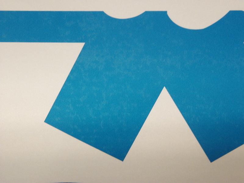

Tested. No effect. My blue looks like "metallic" , like if there was space between inkdrop of cyan. Sure, if I print black, I'll be fully saturated but I need to print almost pure CYAN out-of-the-cartridge. 'Done that in the past with success so WHY TODAY IT DOESN'T DO IT? Bad Karma I figure...

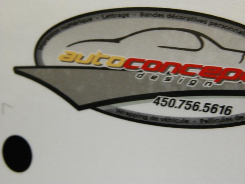

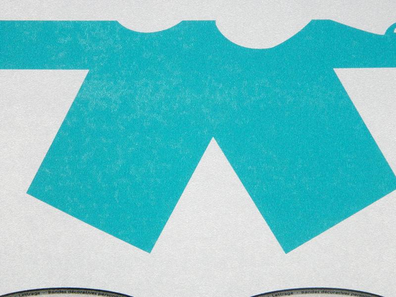

Actually not, ...but thanks for your inputs. Colors print good on other medias (Oracal 3951 - 3551 - 3165 - 3628 / Avery 2903 - 2105 - 1005EZ RS / Bannerss). My outputs have matte spots everywhere but unprinted reflective material is fully gloss.:help
I know you won't really see it but take a closer look at my logo (the grey swash) and the ambulance cross.
