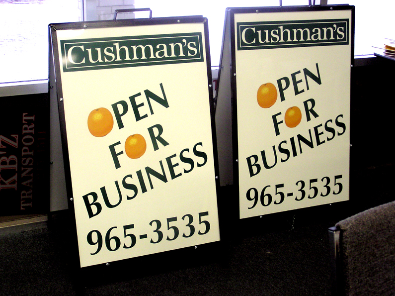

Here's a picture of the finished signs. No great creative achievement .... but a very happy customer.
