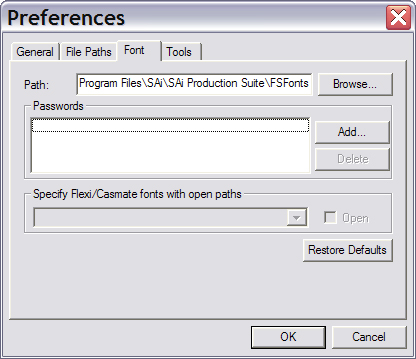

That setting is established in the preferences of Flexi as shown below. It may also be worth noting that all but a couple of those fonts are single line engraving fonts and are not intended for print or cut use. I would check to see what the settings are on the machine not seeing them.
As far as I know all other fonts in Flexi are coming from the Windows\Fonts folder.

The window you described above Fred is the preferences menu that I am looking at as well. The path is the Program Files\Flexi Expert 8.1\FSFonts but there are only a fraction of the FT type fonts in that folder as what actually appear in his list of available fonts, and there aren't any FT type fonts in the WINDOWS\Fonts folder.
I did notice, however, that the bottom option in that preferences window to specify Flexi/Casmate fonts with open paths has been selected with a location in his. Perhaps these are the fonts then that I need. I will see if I can track that location down for additional fonts.
Thanks again for your help Fred!

Sounds like you may have found the difference. Please post back if that is the reason for the difference.
choucove
Update: Went to the Hays office and did get it figured out today. Apparently, that bottom option as I was explaing with the "specify Flexi/Casmate fonts with open paths" was grayed out in the machine not working properly. We went into the Flexi Expert program files folder and found a folder called CASFonts listed there on the working computer with several odd files contained within. Copied these to the other computers and presto, all the new flexifont files showed up in the list! Apparently, these random files in the CASFonts folder are almost like collections of font types and were missing on the other computer.
