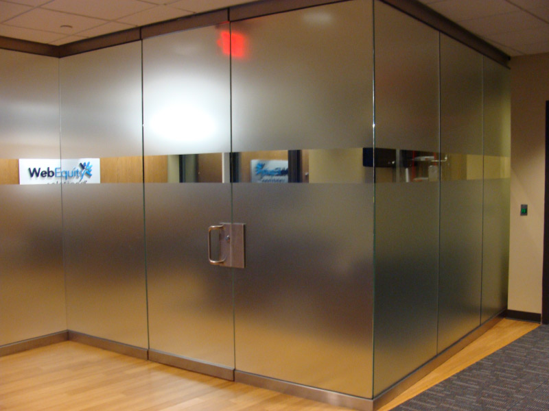

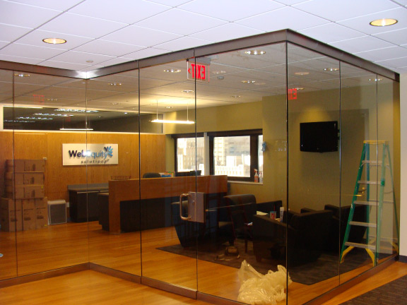

While I appreciate the advice to install wet, I've tried installing wet and am looking for a deeper level of advice. Regarding those nice panels in the office, there is no frame around those windows and they're not full coverage. I could install what I see in those photos no problem. We've already installed three full rolls worth of frosting in this office. It's the big windows with the full coverage that are stumping me.
