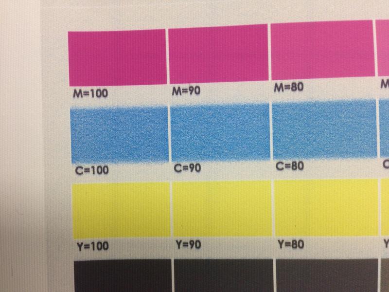

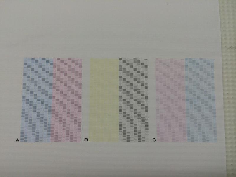

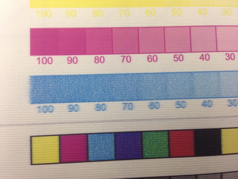

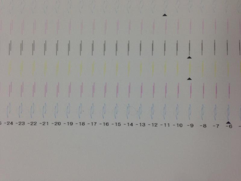

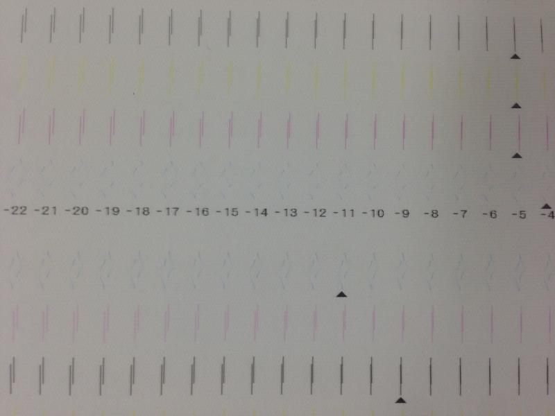

I have a Roland XJ 740 and all in all works pretty well.
However, the cyan and/or light cyan print head may need to be replaced and I would like to know if there is a way I can:
1.- Avoid having to pay the high service fees of my local technician to come and tell me something any of you could.
2.-Maybe avoid having to change one or both print heads.
I've attached several pics showing the how solid cyan colors print fuzzy, as well as Bi-directional test print with the same problem. I've tried aligning all print heads but its not fixing the issue.

Look for a profile in your RIP that is non-variable dot and print a sample cyan square. Usually a non-variable dot profile will be low resolution and fast speed but not always. If it prints a pretty good solid square, it is most likely time to change the cyan head. If it still prints fuzzy, I would start with changing the head cables. It is definitely an electronic issue so it may end up being a bad head board, main board, or slider board. I am willing to bet it is a head issue. When print heads go bad, the smaller dot sizes are usually affected first. That is why your test print looks good. Test prints use the larger size dots.
