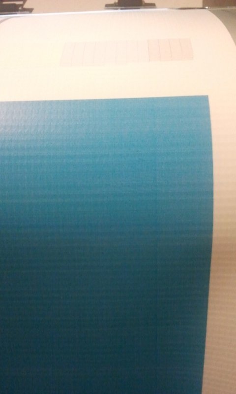

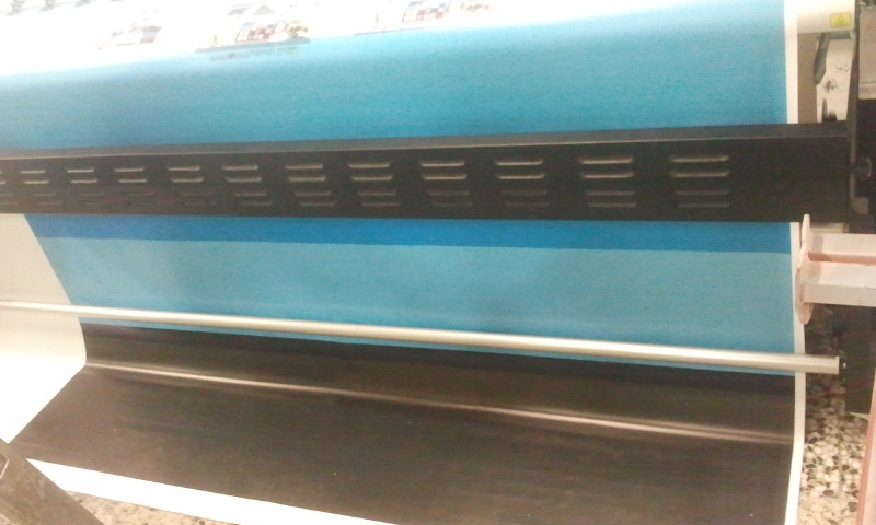

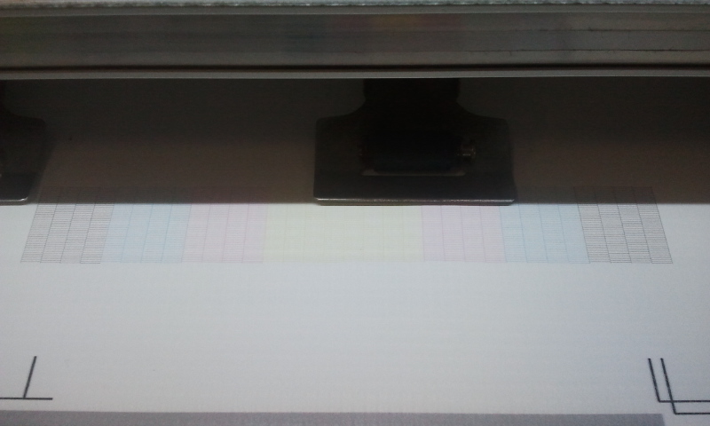

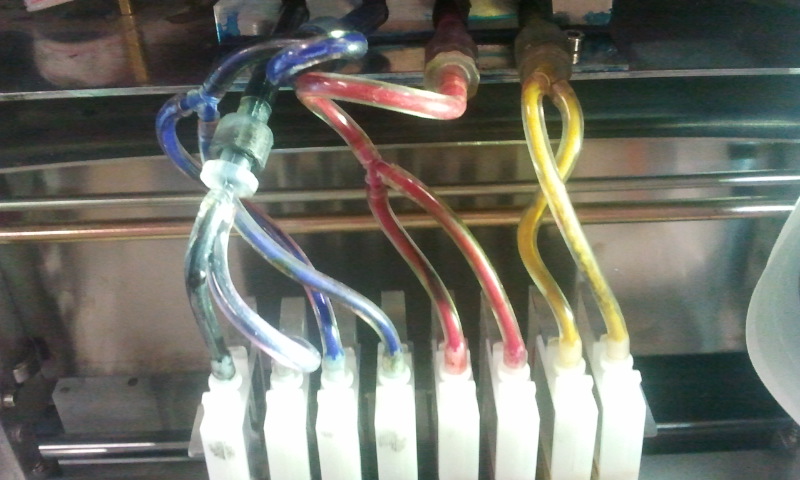

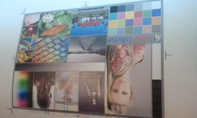

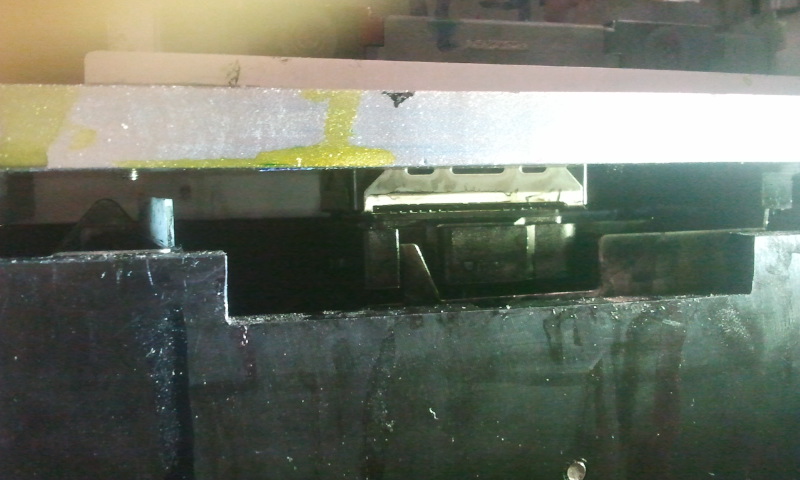

I am able to print solids, etc... Here are some photos.
Just yet I am not sure if it was the ink (changed to the original galaxy ink), the printhead cap module not creating a proper negative pressure or the data cables....
Will keep updating.
With the blue solid, I can see some very faint color changes... could be the banner material... is this normal?? see photo.
