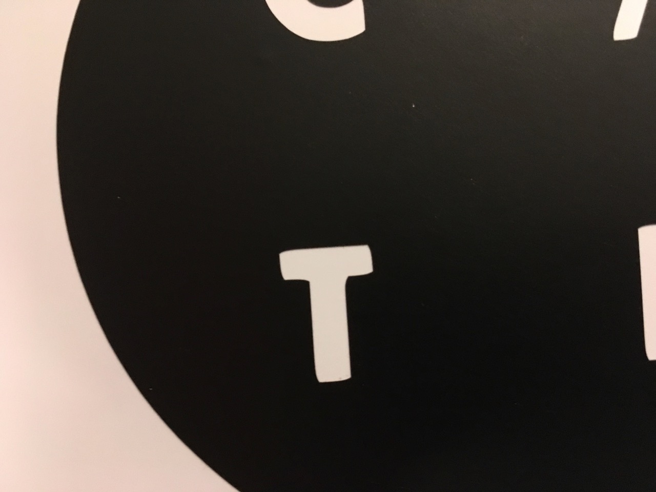

Hi There:
We have a GCC Expert II Vinyl Cutter that has worked perfectly for about 3 years. Just this week the cutting has become very "sloppy". I've attached a picture. In the uploaded example, the font being used was completely angular, but the result is almost like a comic sans style (I think I have discovered technique!). I'm wondering if this is could be an indication that the blade holder needs replacement . These are pretty expensive items so I'd rather not order one if it won't help. I did check and tighten the belts, but only a very slight improvement. Any ideas would be appreciated (motor issue perhaps or ?). Thanks!
Jemski
I found the instructions on modifying the offset in case anyone needs it. Good thing I backed up the install disk!
