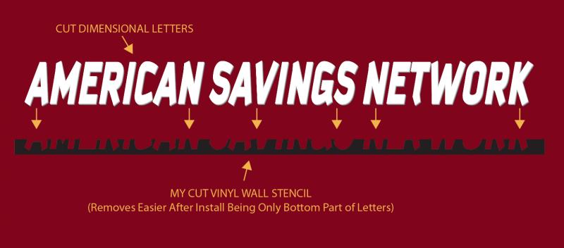

There are tapes out there that will pull the drywall off if you try to remove them. BronTapes.com makes a product called Killer Red. Look into it. It's used everywhere.
But as for the stencil thing.... I aways make my own out of cheap removable vinyl. I make it off the actual file I used to show the client the proof. So I know it's exactly right and how the customer saw it. Plus that's pretty easy to get up straight, stand back and take an over all look right before the letters actually go on.
