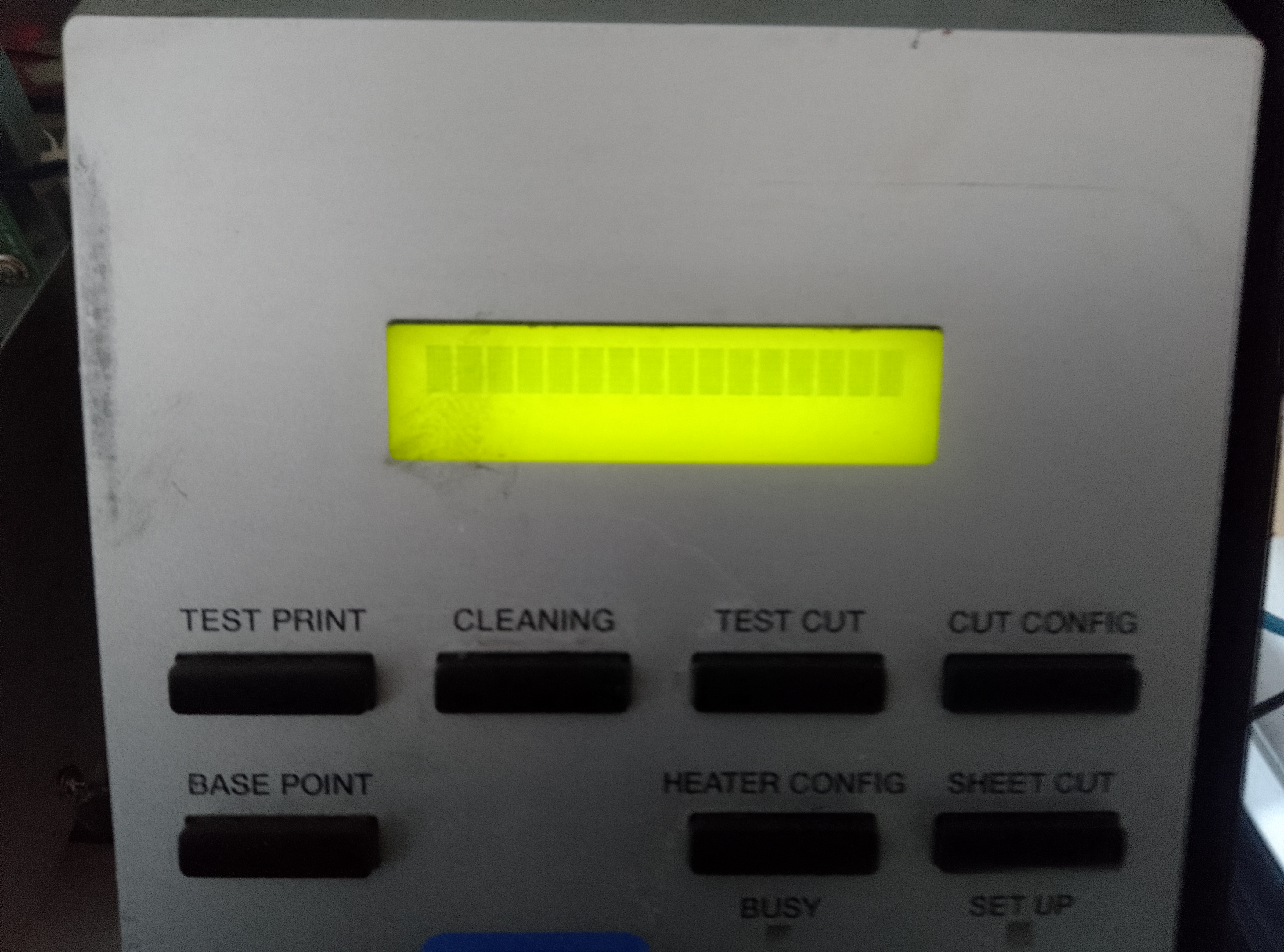

Once we put the board back nothing happened, there are a line of block bricks in the printer display and it won't connect to versa works, we can't even access the service menu

Ok your mainboard is shot and needs replacing. The capacitor blew for a reason and it probably shorted and damaged the main CPU. When you replace a mainboard or just a component then you don't need to use peck to add anything back on, so your printer has more problems than just that

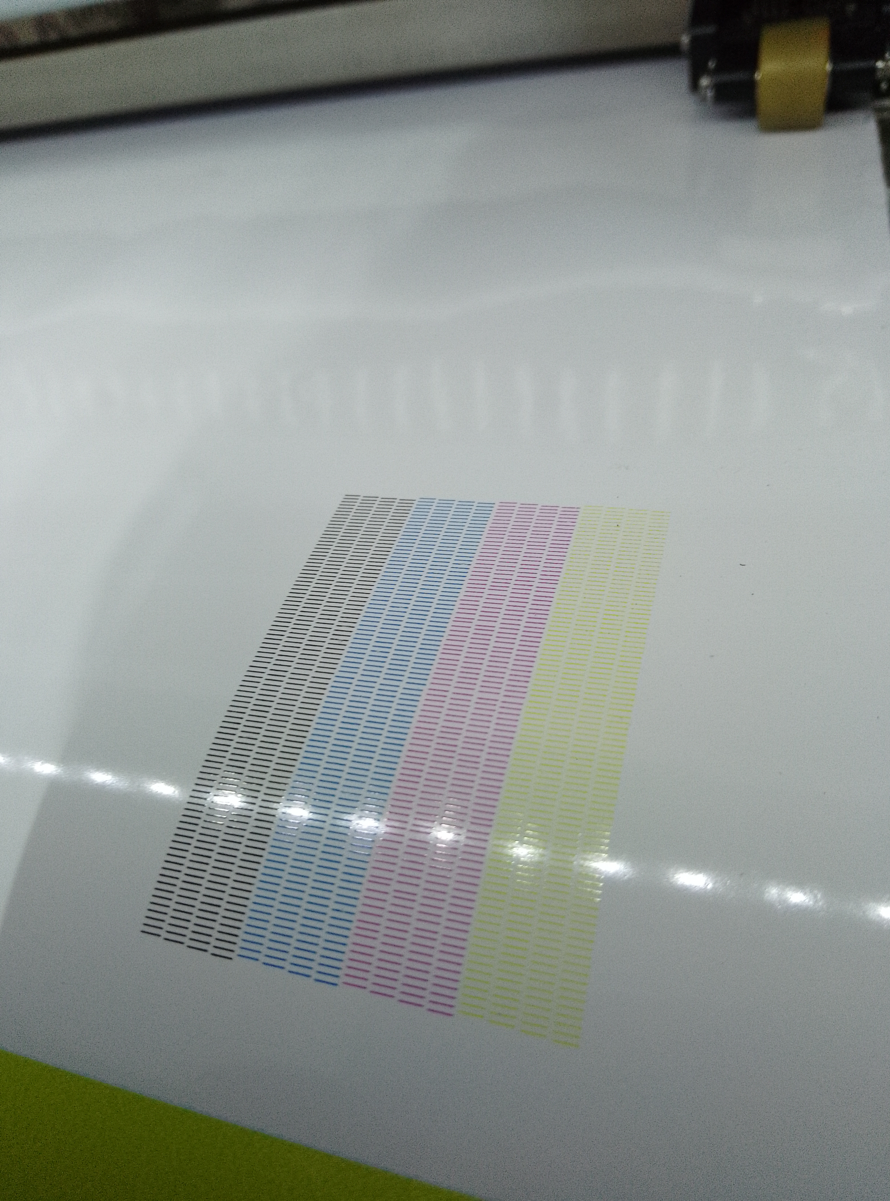

Thankyou for the offer, we have it working good test prints, we changed the fuses, checked all card cable connections and switched laptops, however the display is still showing the boxes, which makes accessing the menu settings impossible, yes we checked the card cable from the display to the board
