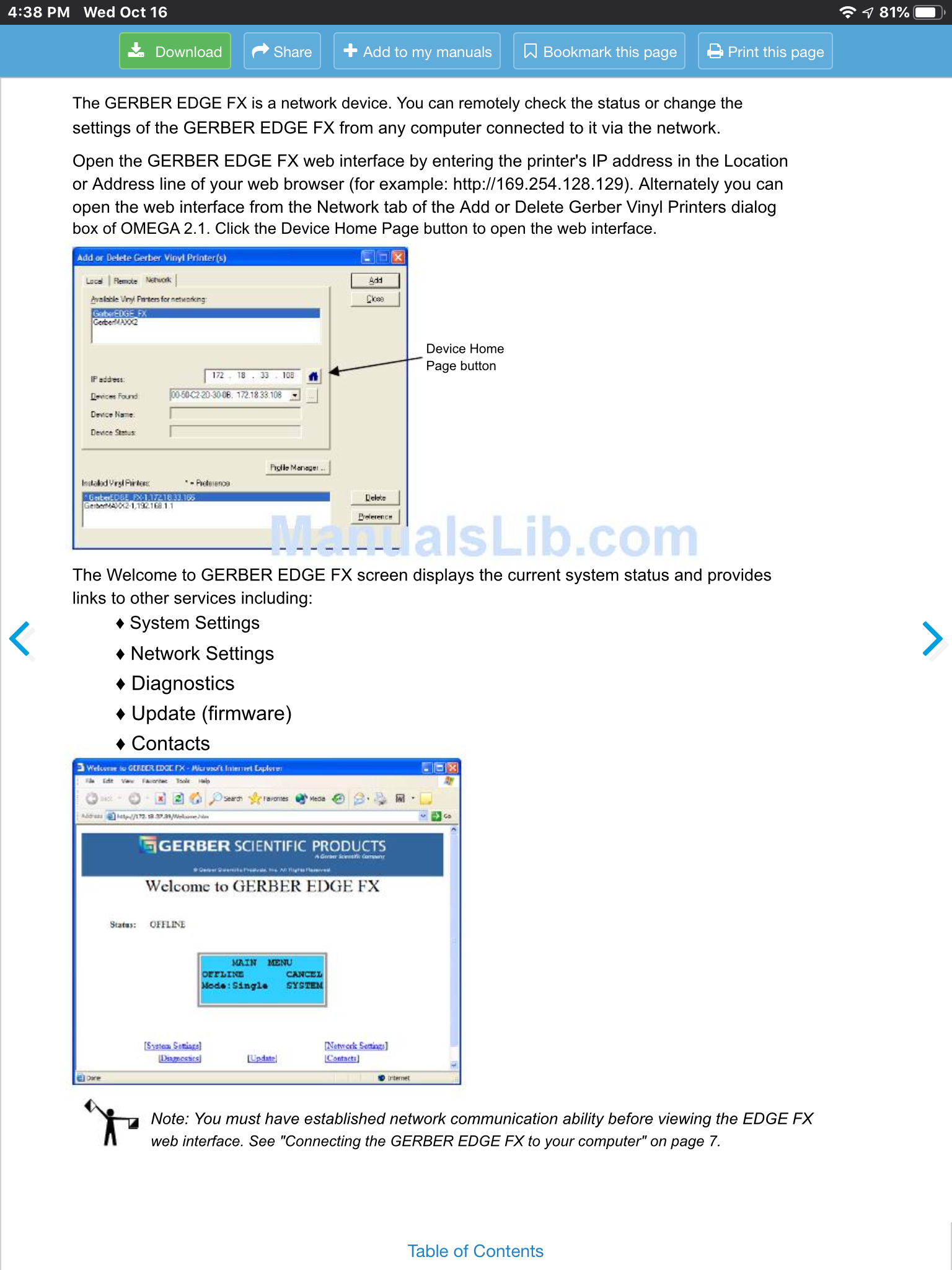

    I am in discussions with people about buying an Edge FX and want to know the print head time on the units but they don't know how to find that. I don't have one yet so I was hoping someone could tell me how to do it so I can get them to check.

    21815B07-940B-498F-A75C-80C606036619.png You have to log onto the FX using the IP address of the machine open a browser enter IP address and the FX menus pops up - google the gerber FX pdf user manual all info is there .

    Great thanks for the help. I will send this off to the sellers.
