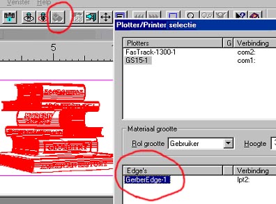

after a new setup the PC recognize the edge not ?? look attachment.
when i click print a job to edge, the gs15 plotter cut a red & black lines (edge & cut lines)
Please wat is the cause!!??
Thanks, Nauras
Fred Weiss
Merchant Member
If the cable from LPT 2 is attached to the Edge
and the Edge is set to "Online"
and the job is sent from GSPPlot by pressing function key F10 ....
You should see the job show up in the LCD of the Edge asking for 3M white vinyl. Pressing the online button once will cause it to next ask for process yellow foil. Pressing it again will cause it to begin printing.
Red vectors in Gerber software indicate a print only assignment. There should not be any way to make them cut without changing that assignment.
