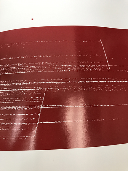

In the middle of a print, our Gerber Edge II started misprinting, leaving streaks all up and down the print area. (see photo attached.)
It was printing 100% then in at a certain point it misprinted about 50%.
It fails with all foils and all vinyls.
I checked all the physical wiring connections and rebooted the computer, but it still persists.
Any ideas on how to resolve?
Paul

Did you remove the dancer bar, and foil squeegee, and check the head connections? Also remove the left side cover, and re-seat upper and lower board connections?
