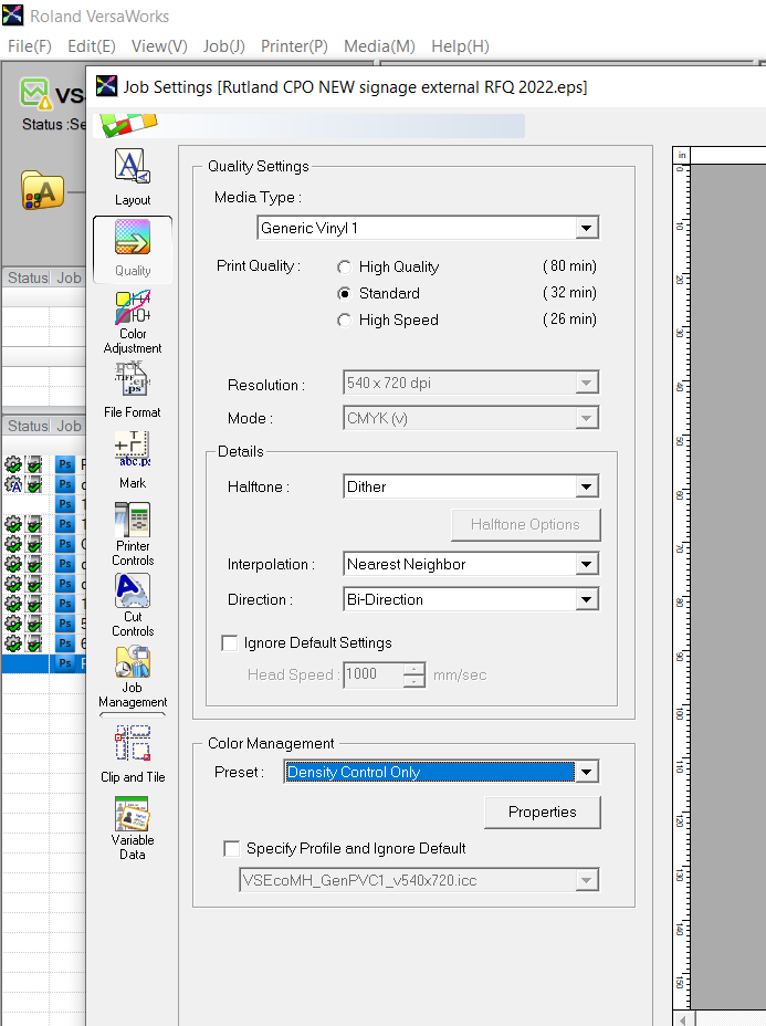

I thought the trick to printing true greyscale ( Like K-only, whether it truly IS or not) was to select 'density control' in the Job Settings menu for color preset. I have NO idea what it means, just that it's proposed as a greyscale setting! good luck!
This "Density Control Only" here turns off color management and will send the document values to the media using the current calibration of the printer / ink / media setup. If a printed gray scale file results in a neutral print it means the setup is properly calibrated to grays but not necessarily color optimized in the modern sense. A proper ICC profile is necessary from this point and properly used as well.
