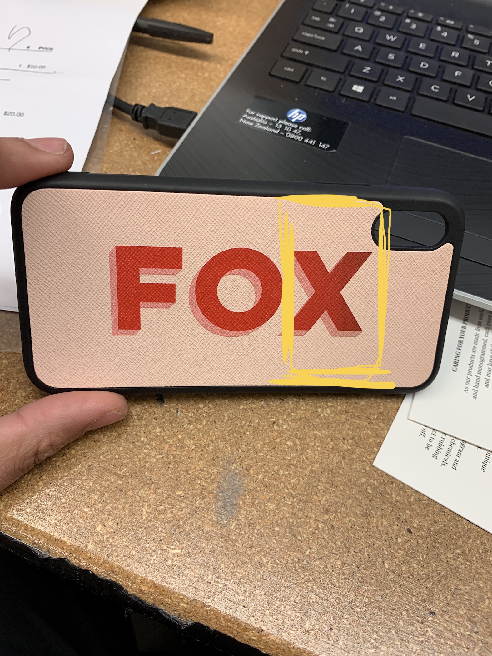

    Has anyone come across this issue?
    I’m using a Mimaki UJF-6042 MK ii.
    I recently upgraded to LUS-120 ink as it makes more sense for the substrates we sell.
    So we transition from a hard ink to flexible.
    Everything went well with the changeover but recently started to get this “gradient” effect in my printing results. More so with “Reds”, yellows, orange. So I would print on a phone case and about 3 quarters of the case is red as I wanted but the top portion of the phone case transitions to a black..
    I’ve been doing everything under the maintenance umbrella. Manual cleans.. you name it.
    If anyone has some insight to this phenomenon please help a brother out.
    I’ve attached a photo of this.
    Cheers

    Did you wash the machine and replace all the ink filters? If not it will take some time for all the old ink to leave the system. Sounds like ink mixing. Also, make sure you are now using LUS120 profiles.
