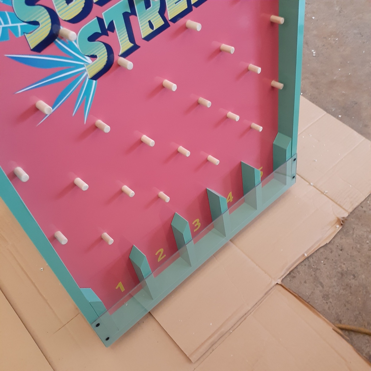

If you are not wedded to using wood for the frame why not make the frame out of the Sintra or a similar PVC material? Home Depot has 3/4 PVC exterior house trim that is easy to work. It has smooth, ready-to-paint finished faces. You can screw it together or weld it with HH-66 and use the 66 to attach the panels to the frame. Once set they will not come apart. More costly than wood but should last forever inside - no termites - easier to paint - won't swell up if the AC breaks down and the humidity goes up.
netsol
I'll stop at home depot and grab a few pieces
GAC05
Quit buggin' me
This is all Home Depot PVC except for the clear acrylic and the wooden dowels.
