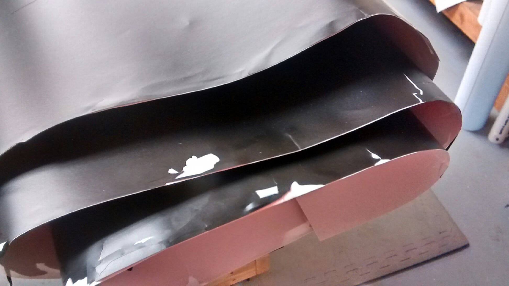

Has anyone done a hood wrap on the new 2018 Camaro SS using the factory GM vinyl? I've attempted 2, both ended up balled up in the corner and I used some Avery satin black I had in stock. The GM vinyl is very thin and brittle and has a high initial tack. It looks like it may be air release but it just sticks so tight before I can get it laid down. Wondering if I could use some application solution?

This is a full hood wrap that come from the factory this way on the SS Camaro. The first two were for the local Chevrolet dealers body shop from damage this one I have now is a warranty job. It was wrinkled under and around the hood vents. I've attached a picture of the factory vinyl I just open the box on. It's cracked all along the edges and flaking off. I just called the dealer and told them they needed to send someone to look at it and that I was not going to even attempt to install it. I've got a roll of satin Avery right here waiting.
