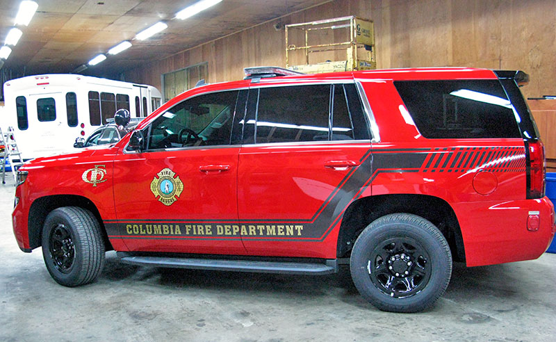

Same. We have also switched to the Real Gold brand. Interesting tidbit is that the guy who started Quick Sign Gold (Jamie Quick) left Sign Gold and is who started Real Gold.... They have made some nice improvements to their materials. The stuff weeds much better and does not need edge sealing which is nice. I've personally never liked the big obvious clear border on the Sign Gold striping so the only other solution was to either brush clear on or use a messy seal-it pen.
Just applied some yesterday even. :) Another plus in my book is you will be supporting a small business. You order it direct from them and they ship it out of Florida. if you have any questions Bill is quick to get on the phone with you.
