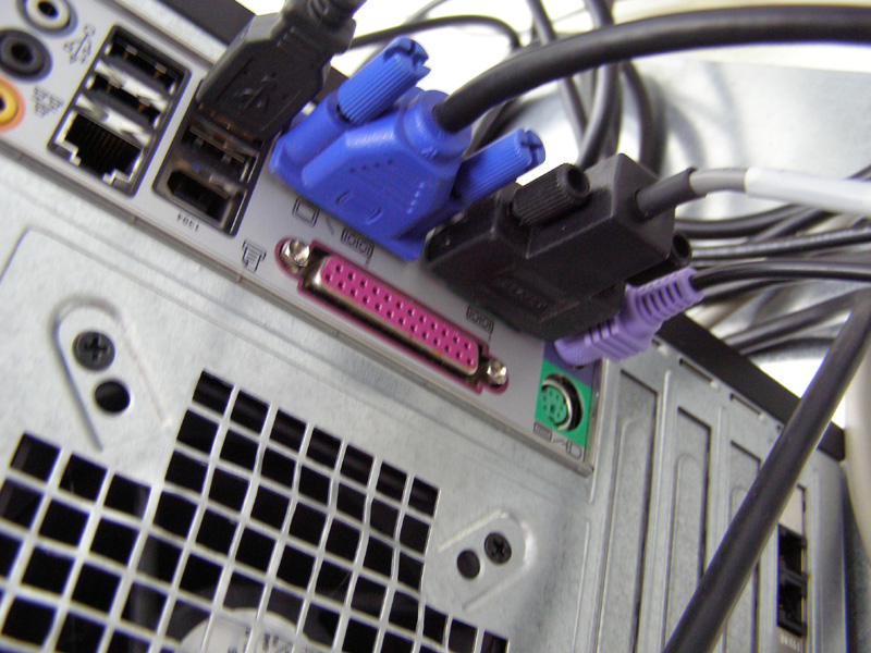

Ok, looks like I do NOT have an "ECP" type port.
So why then did the Edge II work on this port previously??
And why won't the Edge I work on this port, if it does not require an ECP type port?
Second pic shows the port with the cable removed (the pinkish one).

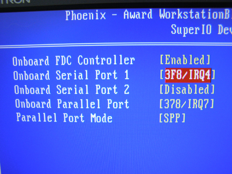

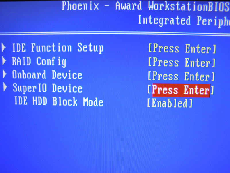

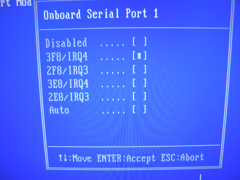

I'm in BIOS now. Can't seem to find ANY settings for the LPT1 port.
Attached are 3 pics (in order) of the closest I can find as far as ports go. And nothing about "ECP".

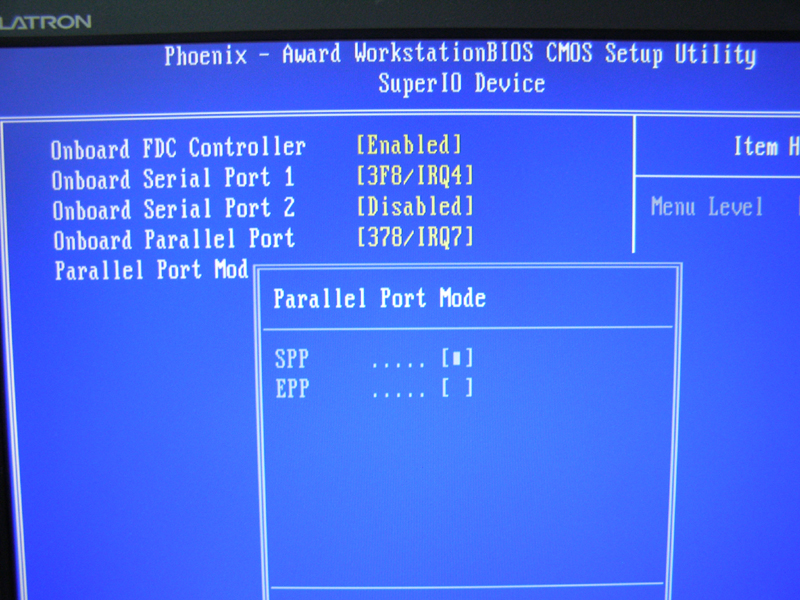

GVP
It's the Parallel Port Mode you need to change - it's currently showing SPP. On most BIOS you just move the highlighted selector to the SPP setting and, I think, hit return. You should be shown the options to change it to ECP.
DeVries Signs
Oh, well...didn't work.
Changed the parallel port to "EPP" in BIOS, then rebooted.
Checking Device manager, I don't see "EPP" now though.

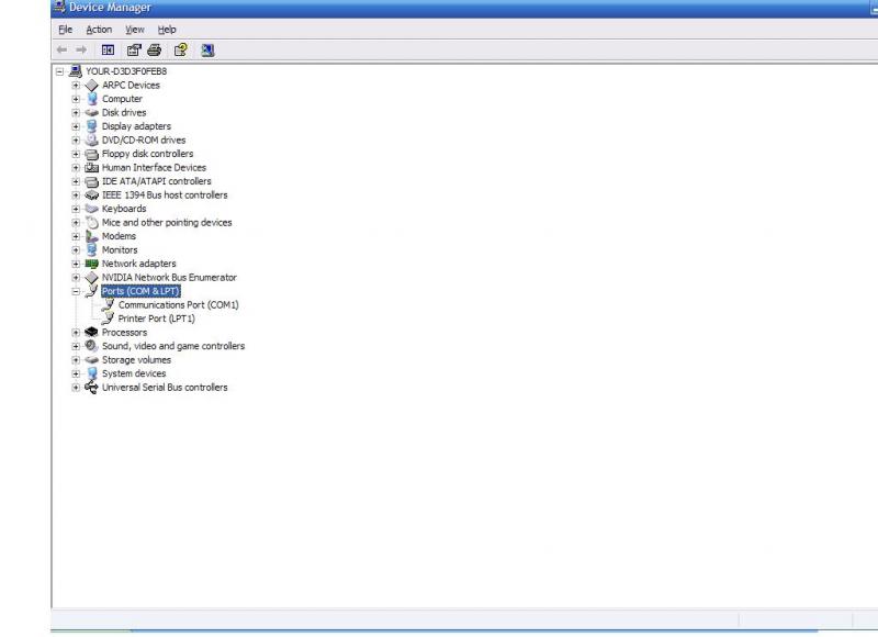

Also:
Port Settings in Device Manager have "Never use an interupt" checked, as well as "Enable Legacy plug and play" checked for LPT1.
Is that correct?

THIS is my computer (it's not that old!) If you hit ctrl + F and type in "ECP", you'll see that the parallel port supposedly HAS that mode option. So why isn't "ECP" showing up in BIOS?? Attached is a pic showing that there is only SPP and EPP settings available, NO ECP.
