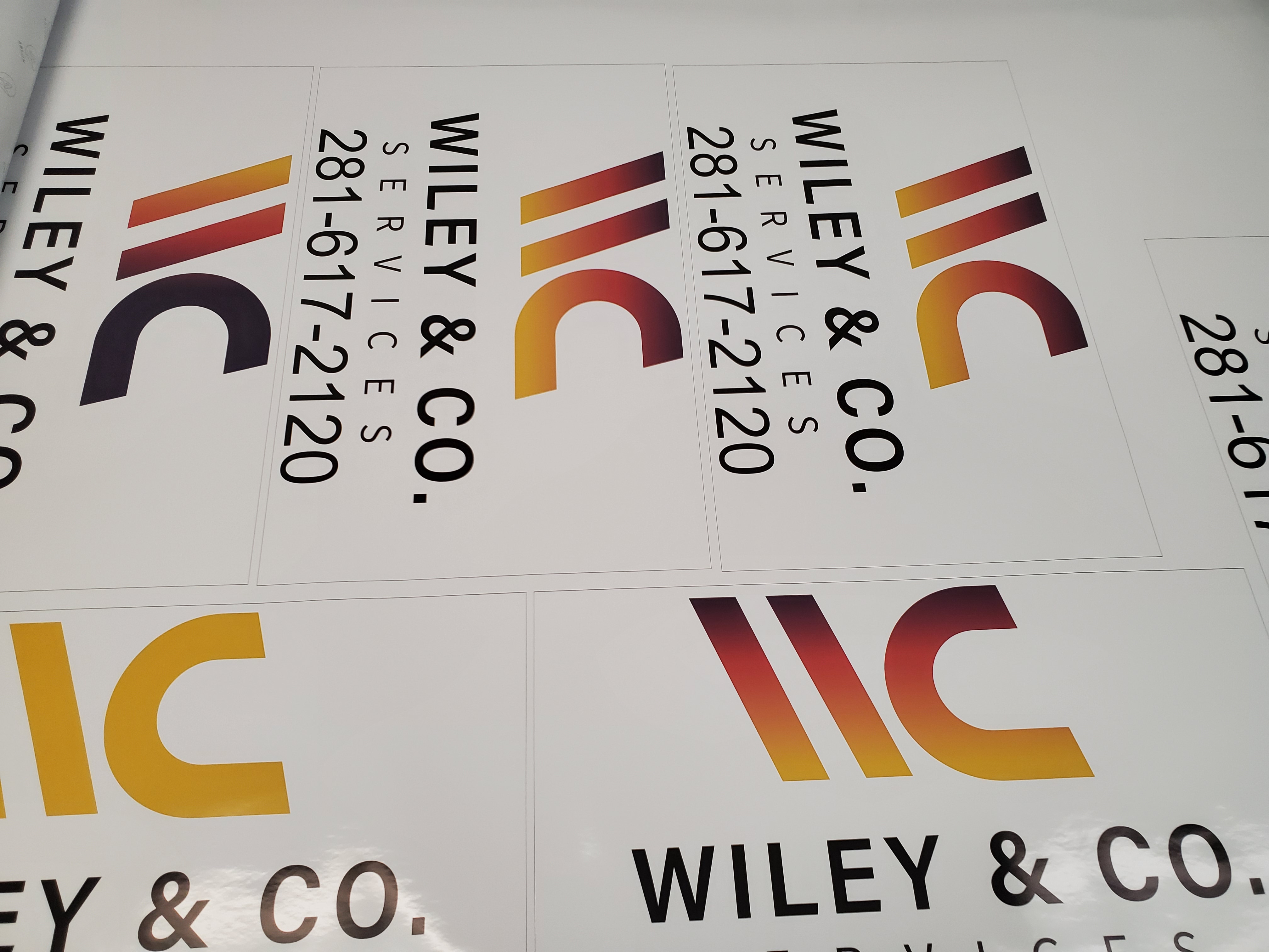

More questions. So before my printer issues I was able to print this same file without issue. The gradient was supposed to go from yellow to purple. But in the photo you can see the various gradients that happened. WHY, after a year and a half am I having problems with gradient printing when I didn't before? Is it a printer issue or a software issue? i Just don't understand it.

It doesn't look like a printer issue to me. It seems like the software is reorienting the gradient angle when you nest them which I don't know what would cause that as I use Illustrator for the most part.
Looks like you have user problems.
Somehow, the way you're saving things does not remain and whenever you turn or nest things, the gradient takes on a new creation.

Ok. So user problems. Here's what I'm doing. I received the graphic from the customer in PDF format. I size it and export it in a pdf. then I import it into flexi on my rip station and put a contour cut around it. Then duplicate and next where I need them nested.
I DID go back and export the file into a jpeg and it seems to work.
My real problem is that it didn't seem to do this before I had printer issues. Now it seems like I'm having the issue with each gradient. Someone earlier said if it's not my artwork I need to export it into a bitmap after it's sized.But I didn't have to do that before my printer issues started??
