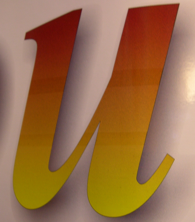

Mutoh 1604, Oracal 3651, good profile (no previous problems), Onyx Production House RIP V7.0.
Art has a gradient that is banding (see attached jpgs)
The file was made in Corel X3, Converted to curves, using CMYK colors.
Exported as EPS in opened in the RIP to print.

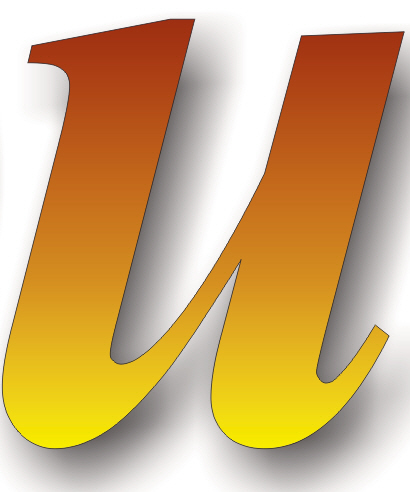

The left image is the print, the right one is a screenshot of the file in Corel
Any ideas wassup with this??

As a general rule of thumb, never try to print gradients with a decent color shift in vector format unless you rasterize the gradient layer. It's not worth the hair pulling IMHO.

Draw a box and fill it with the fountain fill. No outlines. Convert to RGB bitmap and power clip it into the vector.
