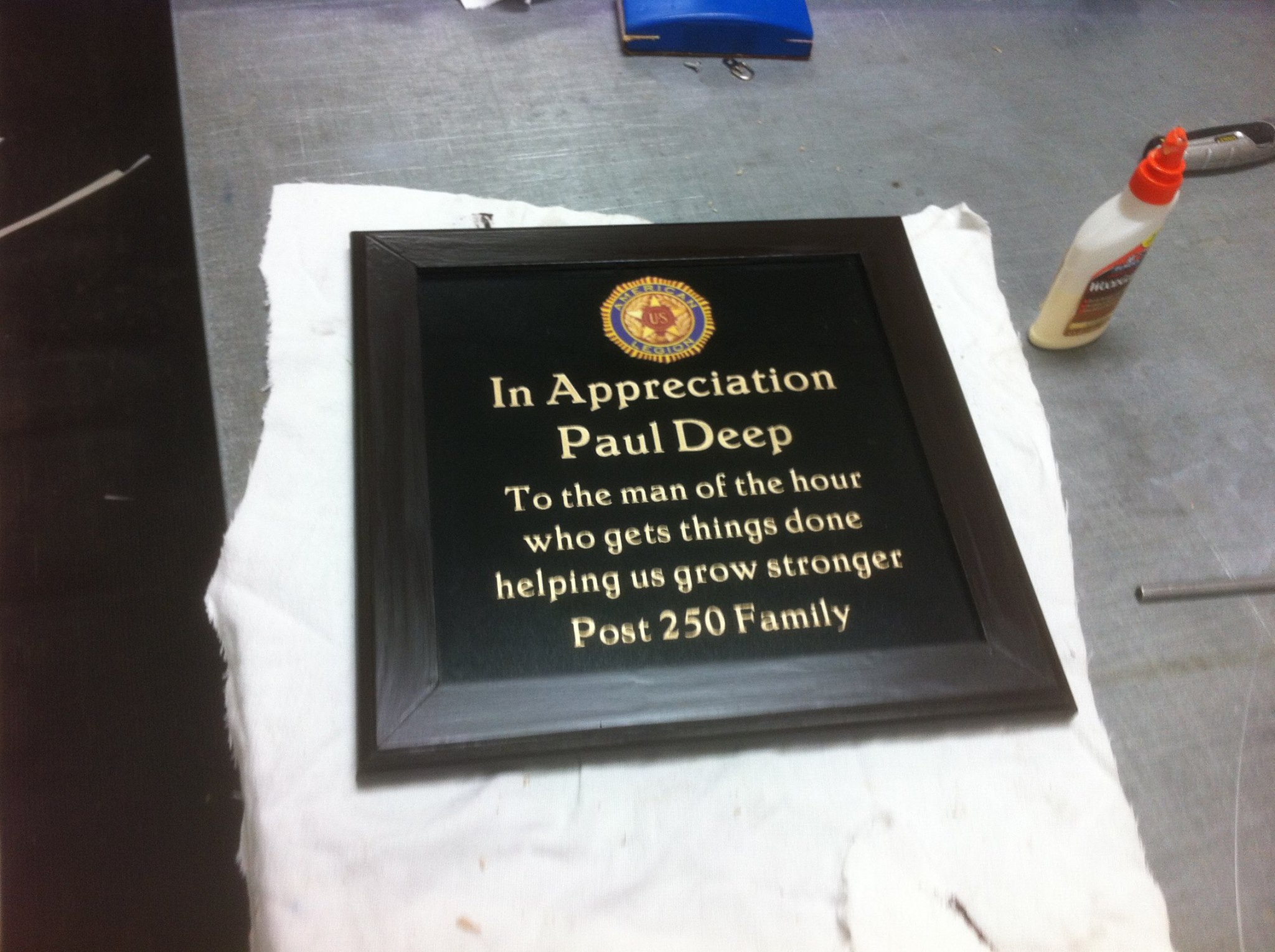

I blast granite tiles for our local Am Legion Hall Memorial Wall. I use iron oxide (80 grit) and a cheap pin gun from harbor freight. I have a very old blast box. I use a double layer of cheap, old, calendered vinyl cut on my graphtec. Ocassionally for very special charity events I have produced some plaques of granite blasted, painted, then trimmed in wood and stained. The attached pic has a digital print as well at top. For these simple etching projects my set up works. Anything more involved than that I would send out.
