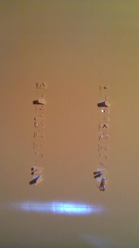

    I have the 500ce when im cutting small fonts it shreads them . it looks like its weeding itself ,causing hours of headaches. Is there a setting for fine detail work? Or do i have the setttings jacked up i replaced the blade and set it up till everything just weeds clean on the test....any help would be great thanks:thankyou:

    Often times when this issue occurs it is because the blade protection strip (BPS) has cuts, dings, and grooves in it. Move your blade to the home position and run your finger along the length of the BPS feeling for aforementioned cuts, dings, and grooves. The replacement procedure is quite simple and www.graphtecamerica.com has them available direct.

    yep
    It does have grooves in it where the blade was set to low but only on the right sidethe more you go to the left it looks good ill move it to cut over there and see if that works im pretty sure it does it everywhere on the mat

    Until you replace the teflon strip, you can lay a piece of vinyl across the length. remember, this is a temporary soltuion to a problem that needs to be fixed.

    got in tryed it on the left no go there either took a pic of the mat looks worse with the light on it ordered a new one . hope this fixes it up thanks for the help

    Looking at the pics supplied, the BPS needs to be replaced. It is very possible the blade is chipped or the blade holder is not swiveling properly for a clean cut to be produced.
    Any of those three issues can cause poor cutting.

    I agree also that the strip has nothing to do with what your problem is. New blade, preferably a 60 degree blade with just enough force to kiss backing paper. 30 or 45 degree bit will work better on bigger letters.

    It could be the holder, too. They wear out. But first elimiate the cutting strip as the culprit, since that's the cheap solution. if you haven't already, flip it over, cleaning the adhesive layer from the good side and then adding adhesive to the worn side ... and reattach it.
