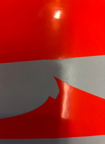

My Graphtec seems to be stepping the cut at the end of a panel and beginning of the next.. Is this something in my settings ? Panels are set at 36" with a . 2 overlap.
In the image.. It's supposed to be a complete radius not stepped over.

Check your offset setting and make sure it matches the blade. If you changed blade angles recently but didn't change the offset, it give you issues like this. If the tip of the blade is broken or rounded it will also mess with the offset.
