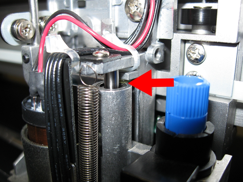

Issue SOLVED
I solved my issue.
Refer to the photo. The problem was after the knife sat for awhile there was an ever so slight "stick" at the point indicated by the arrow. This cause a very slight delay before it would drop, and thus the missed cut.
I cleaned it with a lint-free cloth ever so slightly wetted with Iso. Works perfect again.
I hope this helps someone else sometime.

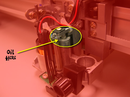

Same thing happened to me a couple years ago.. I made a thread then just like this one and posted a similar picture!

The Graphtec technician almost had a coronary when I asked him if I should lubricate that part, before I knew the cause.
In my case it wasn't about lubrication just that the cylinder was "sticking" to that little pad. Since we got the printer the cutter has been quite idle.
