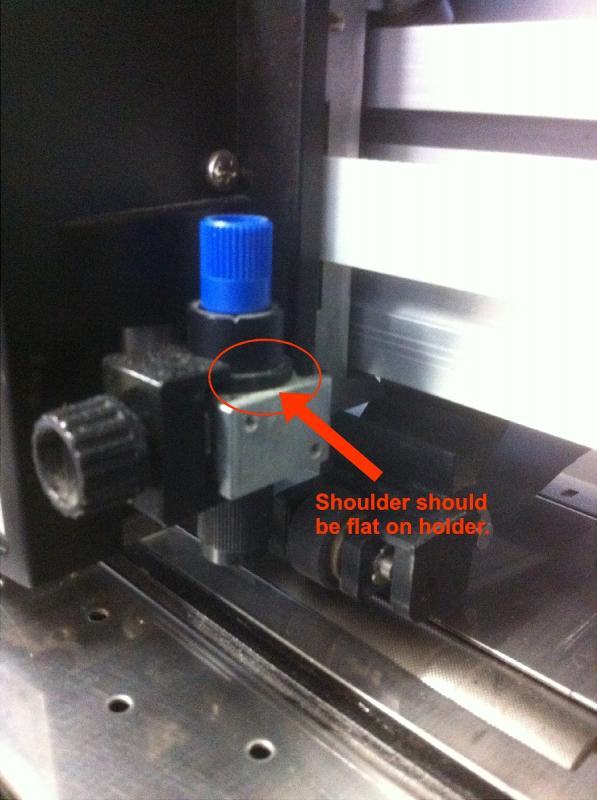

The blade doesn't need to be out further to cut.. You need more pressure.. Turn the pressure up. I have mine set at 18 for regular vinyl.
Make sure the blade holder is seated properly as shown in the picture.

Thanks to everyone for the help. It turns out that I didn't have the blade holder seated all of the way down. Never even noticed the could happen....thanks for the picture!
