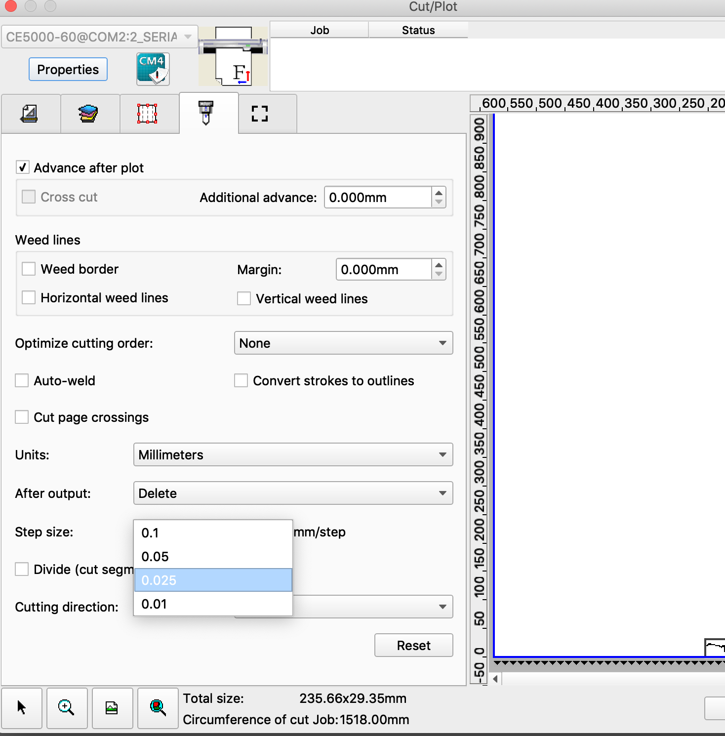

Also verify that "Job Size" in "Cut/Plot" menu is 100.0% and that "Fit to media" is unchecked.

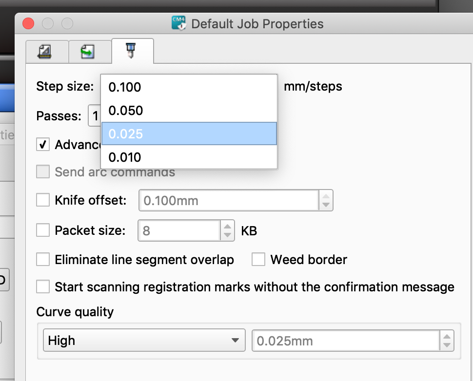

GPGL Step size needs to be set to the same on the software and on the cutter. Default is 0.1mm, but I have found that too large for small objects. Recommend 0.025mm.
BetaCtz
Is there any good rule of thumb for which GP step size to work with?
Any pros/cons to running a smaller or larger one?
I have familiarized myself with where to set them on both my machine and Cutmaster software.
Attila Nagy
It is a Legacy thing. I am not sure why Graphtec still apply it on they cutters. computers and USB ports are fast enough to use 0.010. but the standard for most of the cutters is 0.025.
