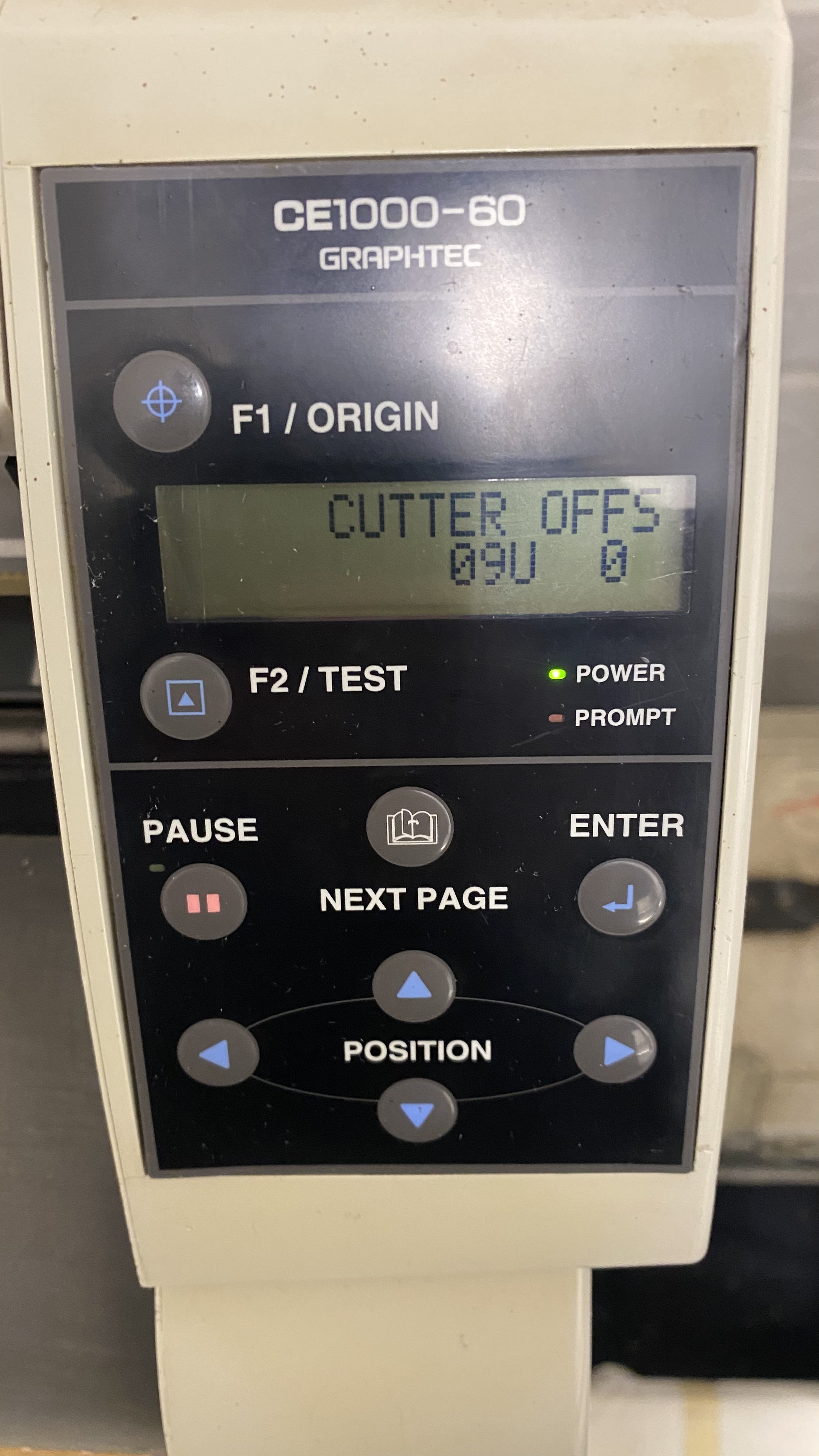

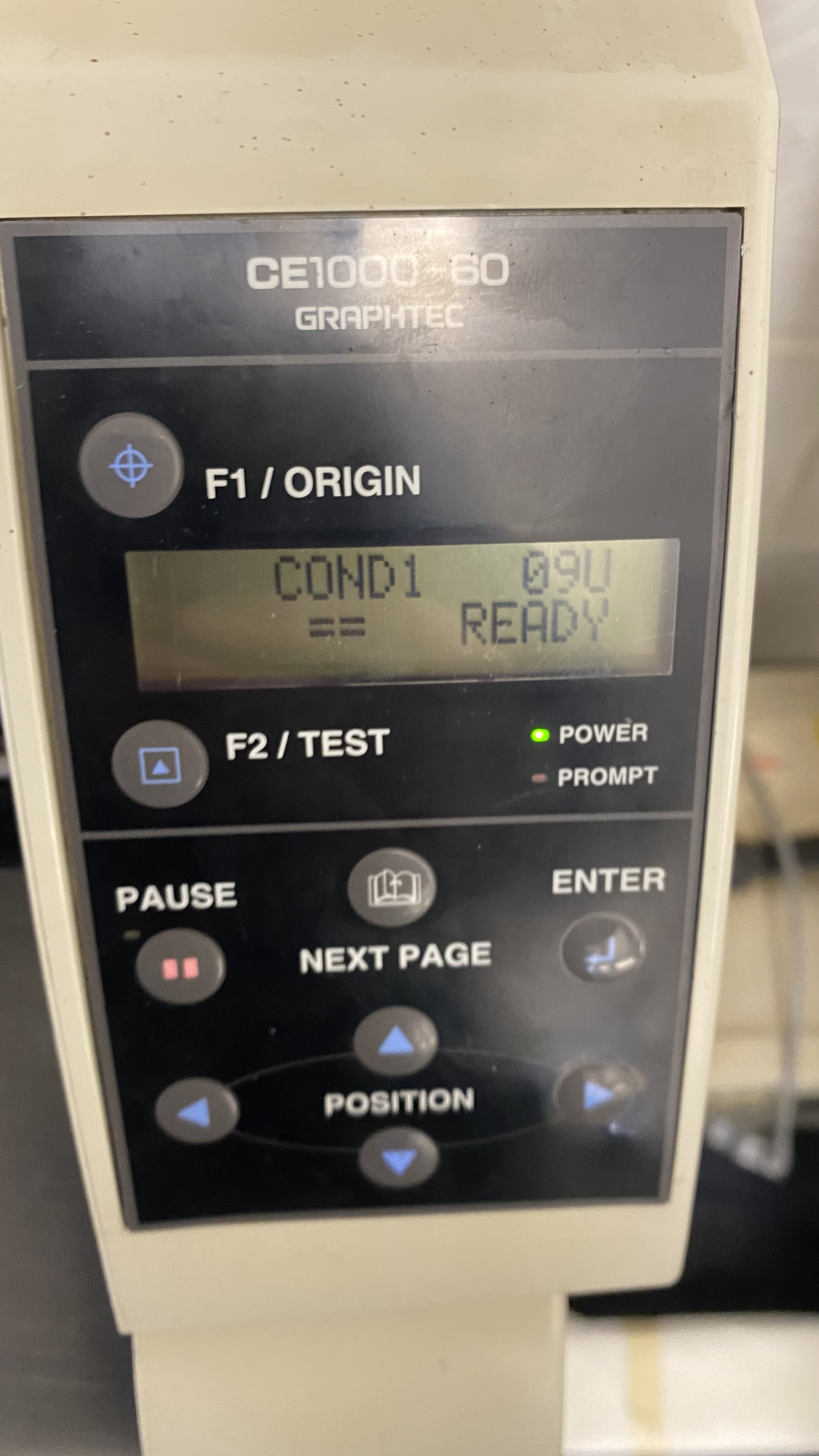

Ok update I managed to find a board in china they said it was for the ce1000 old stock it was 220 dollars steep but I thought if it works worth giving it a go it turns out I had all the issues same as the guy who started the first post screen mountings all had to be modified had to remount the main board as screen display was upside down and then when all fitted and powered on display is pushed to the right cutting off text like the media width.
See photos

You could work around this. If you're using cutting master, there is a poll width function, that asks the plotter how far apart the wheels are.
Edited to say, I spent 5-10 years not realizing this was a feature. years. I would run from the plotter to the computer and punch in the mm width, along with "mm", every time I wanted to plot something...
Yes fortunately I can still see force and speed and blade offset just unfortunately it displays length before width on the plotter other way round I’d be ok I’m using omega composer an old 2001 version which doesn’t display the cutter width it was set up over the phone years ago by Graphtec Uk I think because the model of plotter was not listed it was set up as generic which locks out all the control settings on the computer end so it might normally show it if it’s set up to a listed plotter model or may no I don’t know if anyone does I’d be interested, yes I know what you mean running back to the plotter to check.
